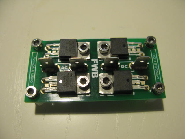

Got the avondale bridge now, however, i must ask further questions before i install this. putting in the big capp blew the fuse, should i have put some snubber caps in before the big caps to reduce the load draw, or will a soft start module fitted at the mains end be a better install. i have put the old caps back in and checked everyting. so any advice welcome before i install new bridge and blow it up!

These are pics of the bridge from avondaleaudio, nicely made comes with connectors and CD to advise install plus other useful info.
will be installing next week, with 2A fuses.
