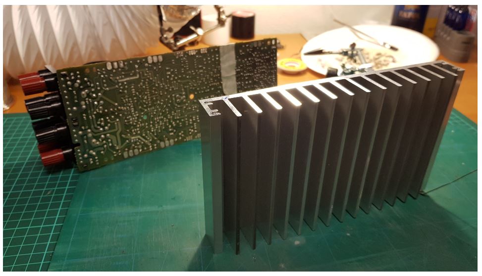

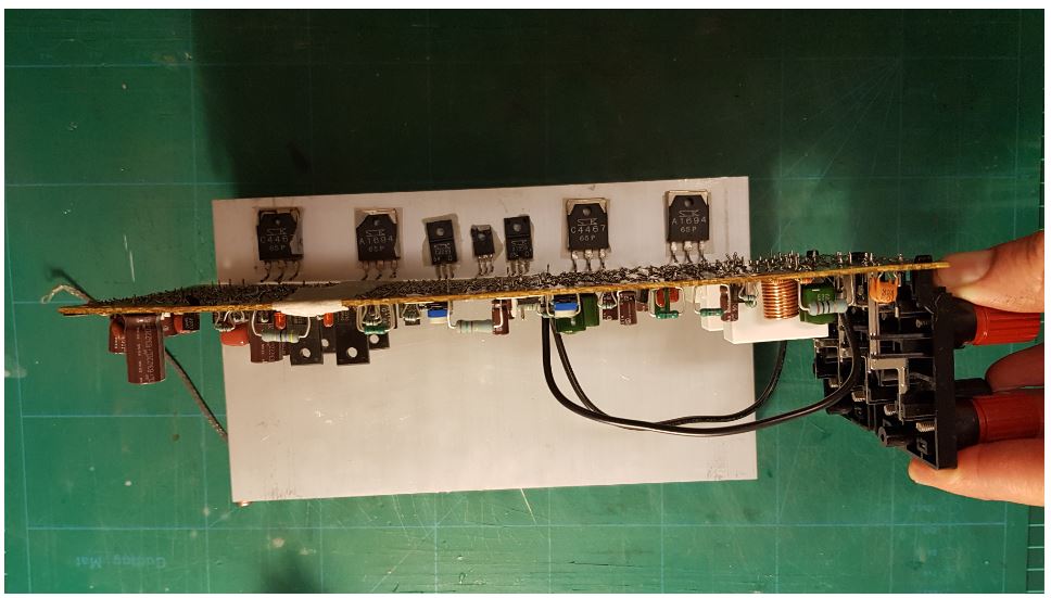

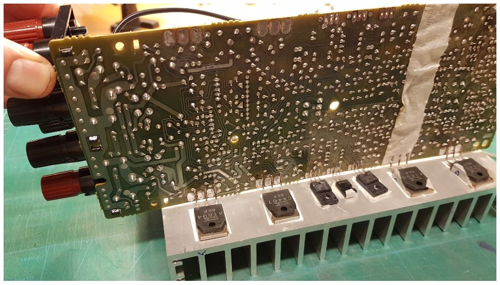

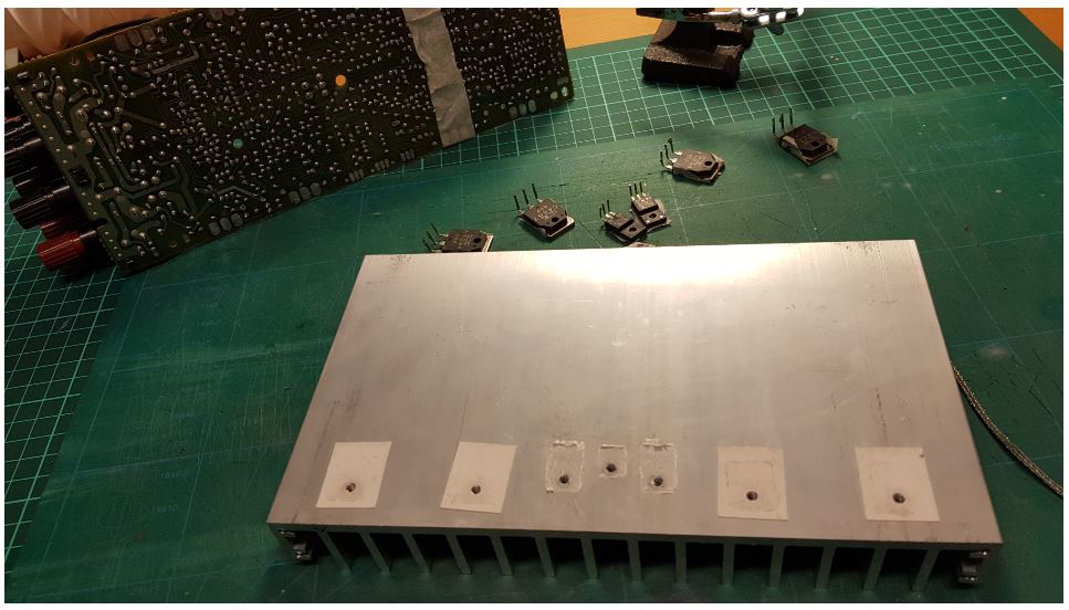

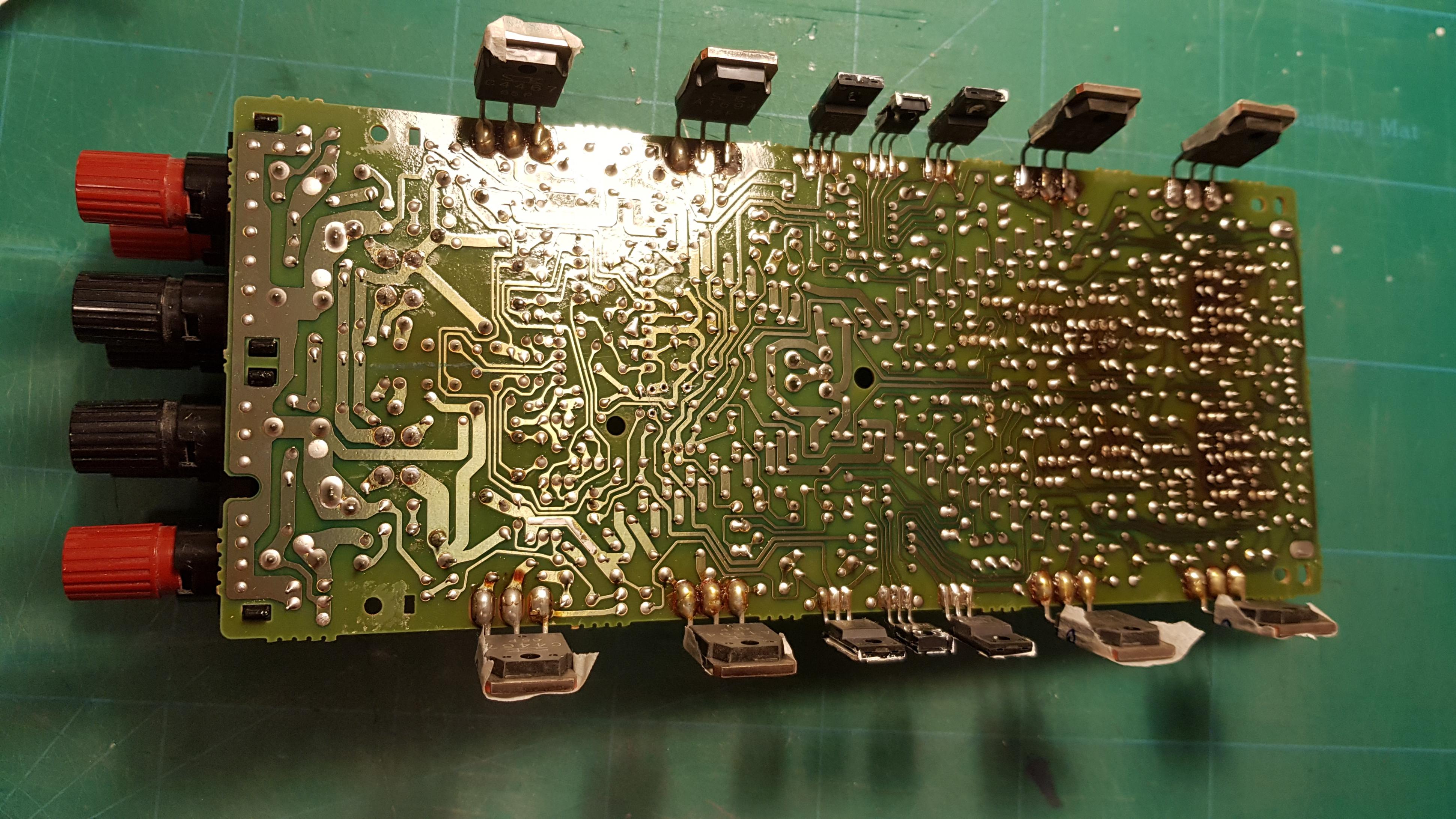

I have found a top view photo of the internals of a PM80 MKII but it is not obvious to me how the transistors fix to the heatsink and what insulation is used , do the heatsinks bend under at the bottom and give a flat surface for mounting to .
This is a photo of P701 underside. The two heat sinks are straight (walls) on either side, transistor legs bent 90 deg to sit flat against sinks. The three small trans' in the middle use thermal grease, while the power trans' use thermal pads
Thanks.... I can see now the PCB sits above the bottom of the heatsinks . Are the transistors then bolted to the heatsinks ?

Pcb sits about in the middle of heat sinks. Transistors bolted directly to heat sinks.

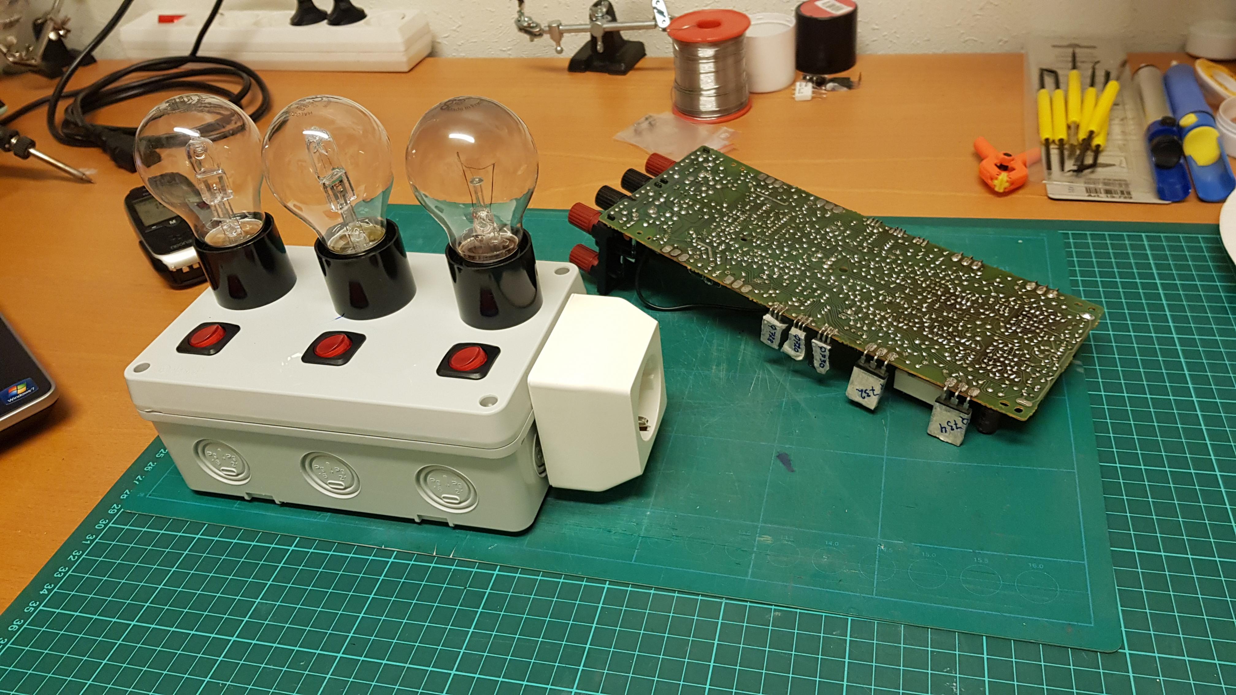

A small update; Finished soldering board P701. Got new power transistors in the mail, still waiting for emitter resistors. Built and tested bulb limiter.

Before this though ( if it is not hard to do ) i would initially repower the amp up ( using the bulb limiter ) with just one pair of output transistors in each channel Q735 , 737 , 736 , 738 ( these have the output current sensing ) just in case there are still problems .
The amp has a double pair of output transistors in each channel which are in parallel so you only need one pair in each channel for power up testing without speakers .
Before power up turn the bias setting pots back to minimum then If you have reinstalled RN05 and 06 and the amp comes out of protection on power up that would be a good indication that it is mostly ok . I would then check the DC output offset voltage and various voltages over the amp just for reassurance . Then tap over the various boards with an old plastic tooth brush handle to check for any further bad joints ( vibration testing ) . All of this with the bulb limiter in use . You could then install all the output transistors and try again . The choice is obviously yours .
I personally would not use the "yellow" straps as they collapse the biasing of all the output devices and this is the area you are trying to prove is now ok . I think the bulb limiting should be sufficient .
PS you have done a neat job on the bulb limiter , I like it .

Thanks! Fun little project, witch I should have done earlier.... Oh well, live and learn.

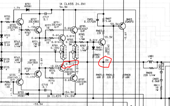

Thanks for taking your time explaining, I really want to learn in the process and not just make haste to get the amp done. Was wondering if my understanding of Output DC Voltage is correct, as marked in red in picture
Yes that is what I am referring to . The voltage there should be in the mV region .

Update; The DC offset is off the charts - in the twenty volt region. I've measured as far back as R755 and get around 18V. Same value both channnels both +VE and -VE
So obviously the amp does not come out of protection. 60W bulb starts bright but dims to a quite faint glow

What voltages do you get at R755 756 757 and 758 .
R755: -17,5V
R757: -21V
R756: -17,2V
R758: -20V
