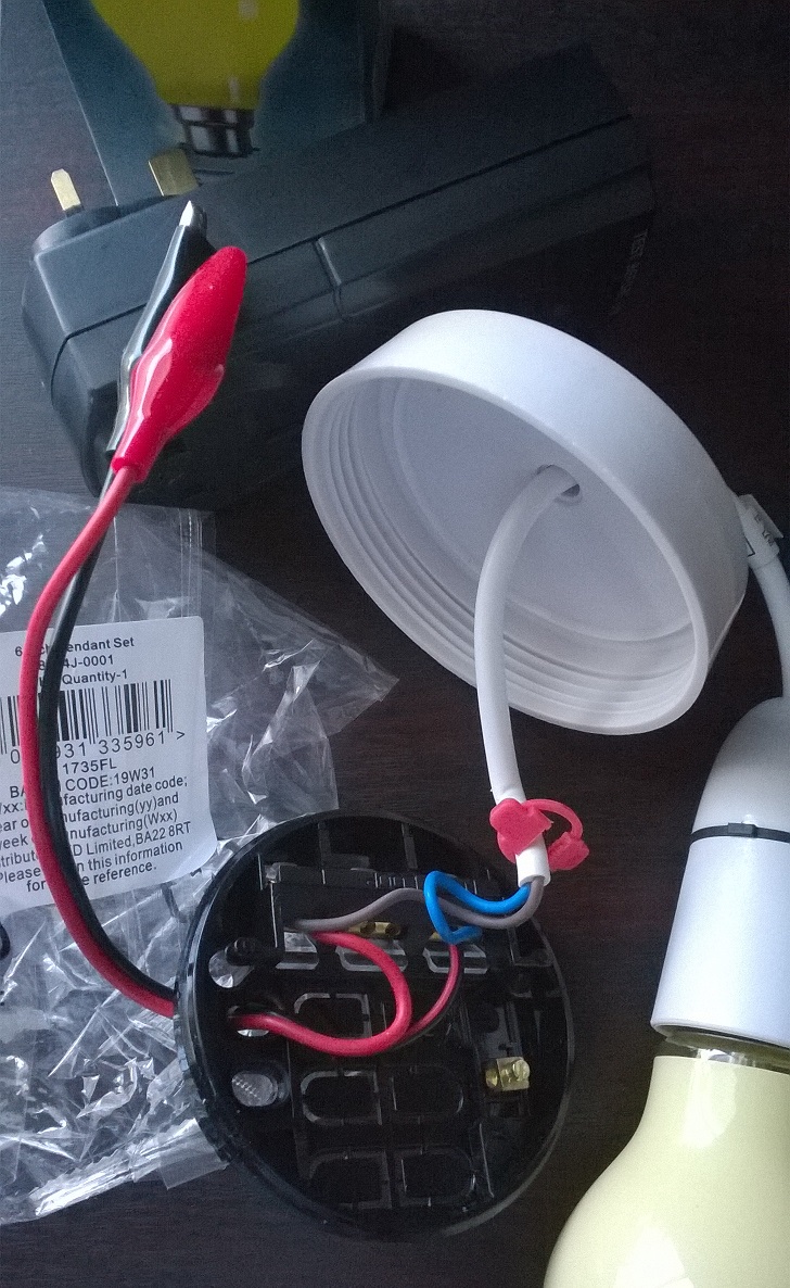

Example 3 - clues on how to build and connect your bulb limiter - if you don't have crocodile clips, you can solder the bulb limiter to the fuse terminals (F901 in your amplifier). Don't forget to disconnect mains power and remove F901...).
Before applying mains power, connect your newly constructed bulb limiter between the mains supply and the internal transformer.
Here's an example of what I used in an emergency situation (I'm a cheapskate);
Portable RCD
Bulb holder
I already had 60W incandescent bulbs availale.
I'm sure you'll find equivalent parts in Norway!

ADDENDUM: Here's my 'emergency' bulb limiter - I haven't even removed the ceiling rose;
If you are already protected by a RCD, you can skip purchasing the portable RCD.

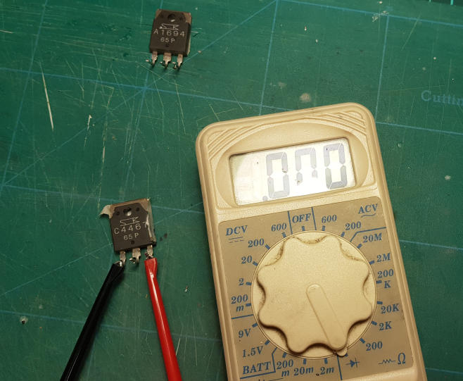

A quick update: De-soldered all power transistors and Q719, 720, 727, 728, 730 (witch I'm not sure what to call)
Q737 and 736 is shorted in all junctions.
Did all the diodes - OK
All the rest of transistors - OK
I also checked the electrolyte caps like we used to do back in school days eons ago, in and out of circuit. We only did this with small ones. Short the pins, measure with multimeter in ohm, watch resistance gradually increase to big numbers. Small caps faster than larger ones. Is this a valid test method, or where we just young and dumb back then?

I see you removed Q719 and Q720 , those will test differently as they are darlington transistors BC junction approx. 0.65V... BE approx. 1.3V... EC open circuit.... all open circuit in reverse polarity .

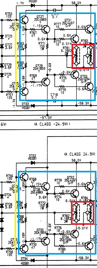

PS check the resistance of all the low ohm resistors around the power transistors 10 ohm , 150 , 1000 and particularly the 0.18 ohm cement resistors ( check they are all 0.18 ohm to there relevant output rails ) .
As suggested, ALL resistors within the BLUE areas need to be checked.
As you've found output transistors with Collector-Emitter shorts, the resistors in the RED box have been severely stressed and possibly destroyed. Check each section of R781-R784 (de-solder if necessary).
And you're correct - whilst 'in circuit' a resistor can NEVER measure more than its stated value (plus tolerance).
Good Luck!
ADDENDUM: The YELLOW link will reduce the potential for unplanned output stage destruction (but you're not there yet).
