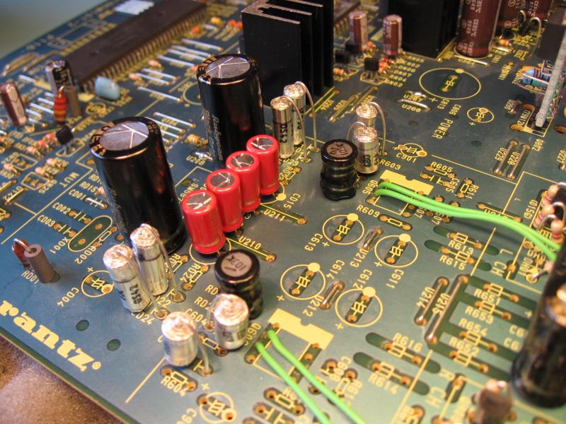

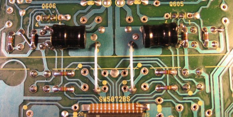

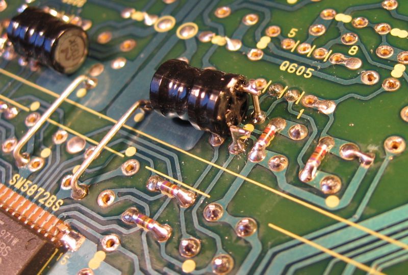

FET output stage
Finally the parts I ordered arrived yesterday, so I could finish the player with the FET-stage i'm working on.
I built a new, serious version of the passive filter part, with 1% PS caps, precision resistors and matched inductors. I've just spent an hour listening to it. Wow. Guys, you really should try this.
The clarity, resolution, it's great. It beats the hell out of my opamp setup. :yes:

SimontY said:
Nice one Ray!
Why don't they make them like that to begin with? :whazzat:
The part count looks low.
Simon
awpagan said:
ray
very clean and professional looking work:D
allan

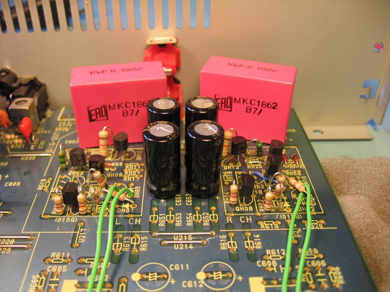

Thanks guys,
The filter part is very easy. Building the FET-stage using the HDAM lay-out is a bit tricky.
But it fits without cutting any traces :D.
I use some MKC output caps that I had, but I think i'm going to put in some Auricaps, or Reliable.
Maybe i'm even going to put those nice shiny metal cans back....
Ray.

6h5c said:
Thanks guys,
Ray.
i'm using wima MKC4 4.7uF out.
was thinking of solen.
allan

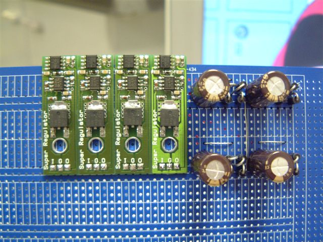

rowemeister said:
Not quite as exciting as Rays discrete output but I thought I would keep people informed of my latest advantures.
Here is a pic of my Servo , RF and HF reg pcb thats going to replace the existing one.
Ive used Schottky diodes and silmic caps with audiocom super regs.
