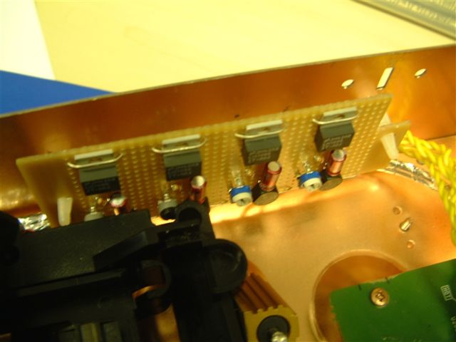

rowemeister said:Here is a pic of my Servo , RF and HF reg pcb thats going to replace the existing one.
Ive used Schottky diodes and silmic caps with audiocom super regs.
Hi Brent,
That's a nice line-up. I thought you had no more room in that player of yours 😀 ???
Ray.

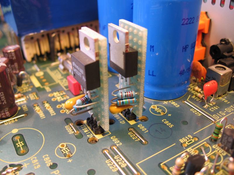

Hi Allan,
You mean this one? Made a nice PDF of it. Maybe i'm going to use this for separate regs for the DAC and decoder, instead of the PSU series inductors I use now. Very easy replacement.
Ray.

Im replacing this pcb
6h5c said:The layout is very simple, it's almost point-to-point. I mounted the LM317 with it's front towards the PCB, so the pinning matches better. Here's another pic of the other side of the boards.
Ray.

6h5c said:
Hi Allan,
Ray.
That's the one
work's a treat😀
allan
