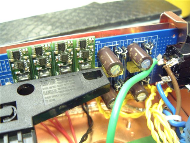

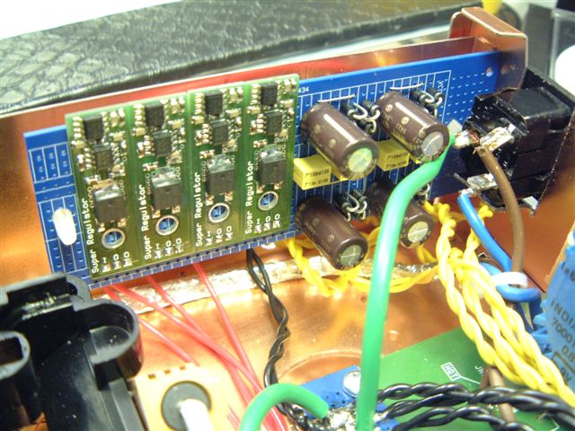

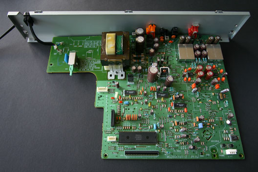

Here are the pics of my upgraged servo reg pcb.
Tight fit :smash:
