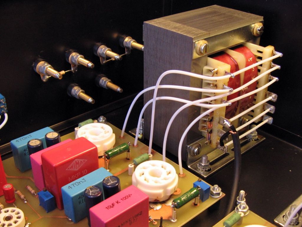

Hi:
I'm butting in here because a link at "Raylectronics.nl" Ray's Audio Page directed me here.
I have a question as to the manufacturer of the output transformer you can see by viewing the attachment.
Thx
Bill @ PEARL
Hi:
Thx
Bill @ PEARL
