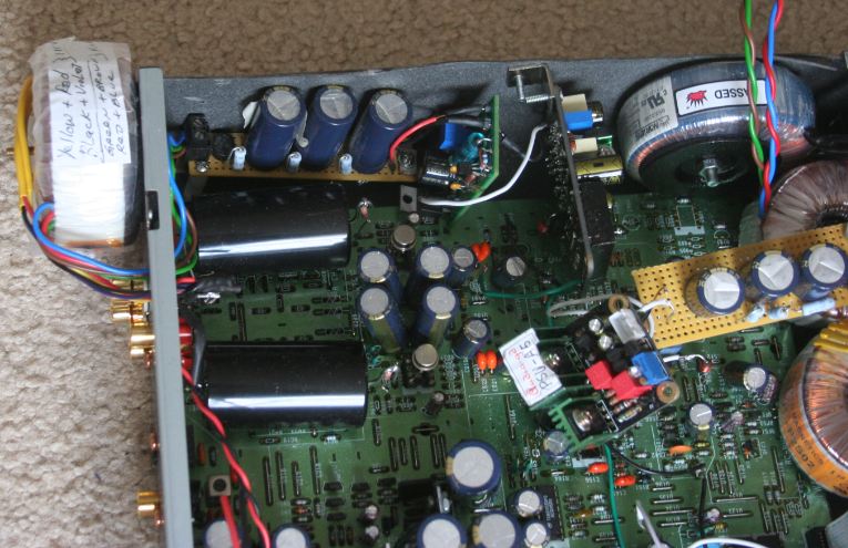

In this pic you can see the big caps for the analogue rails in the original position along with the big 22,000uf cap on short leads on its side for the servo psu. This is one I did for a friend and its been back to me twice for additional work!!! It's quite significant now that's for sure!!!!

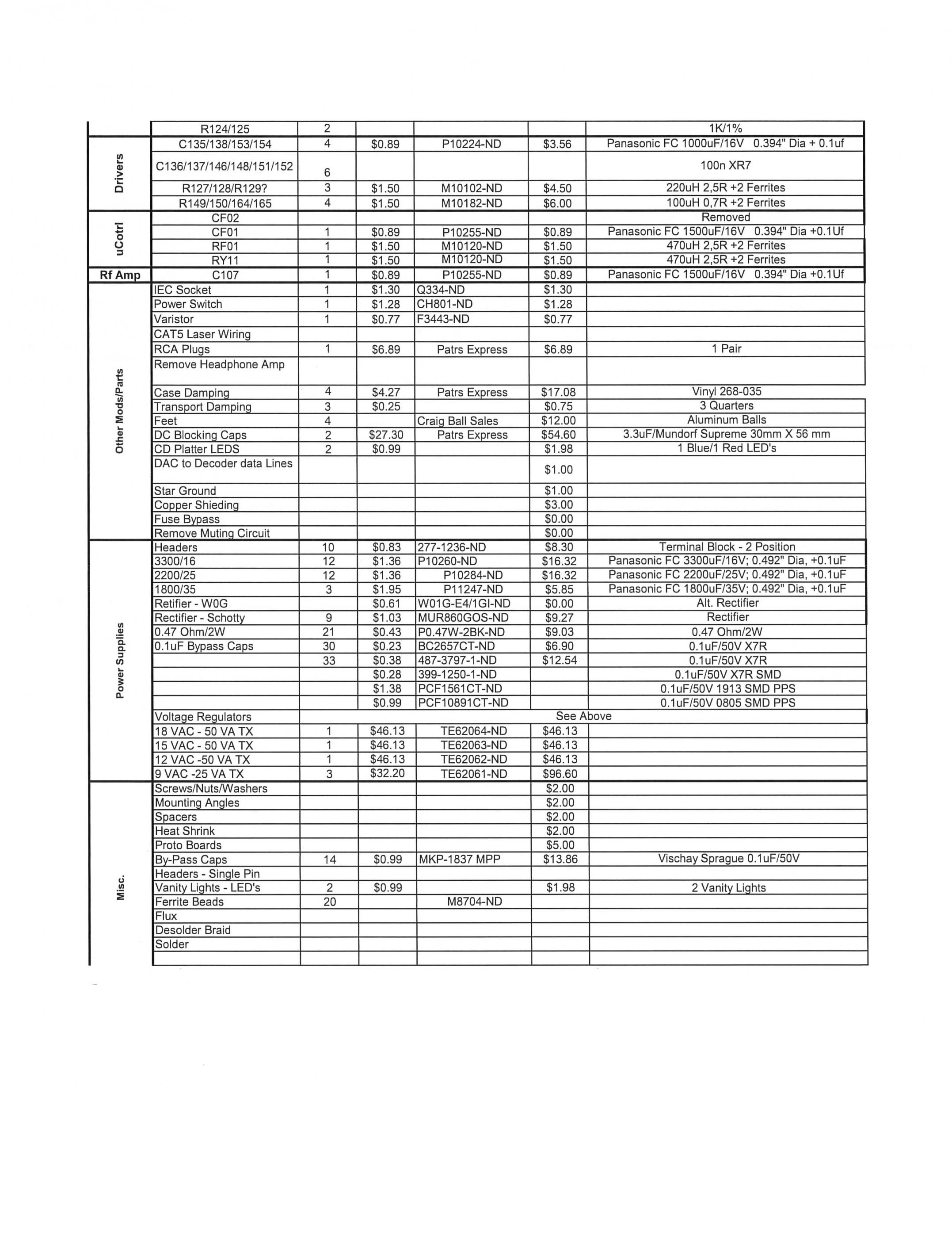

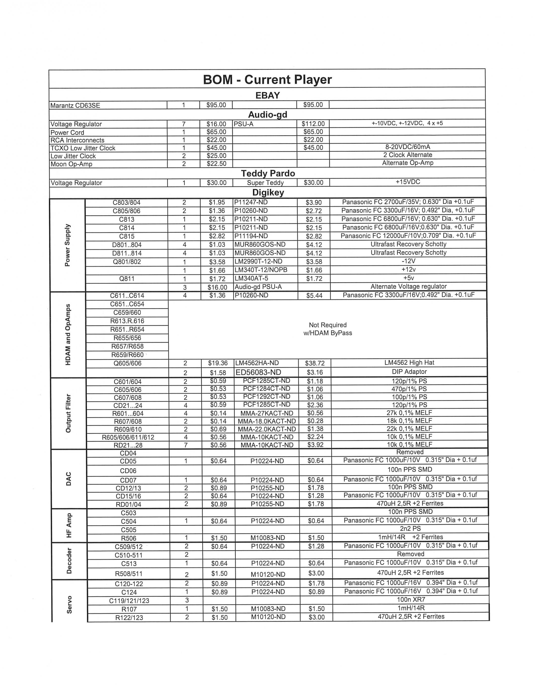

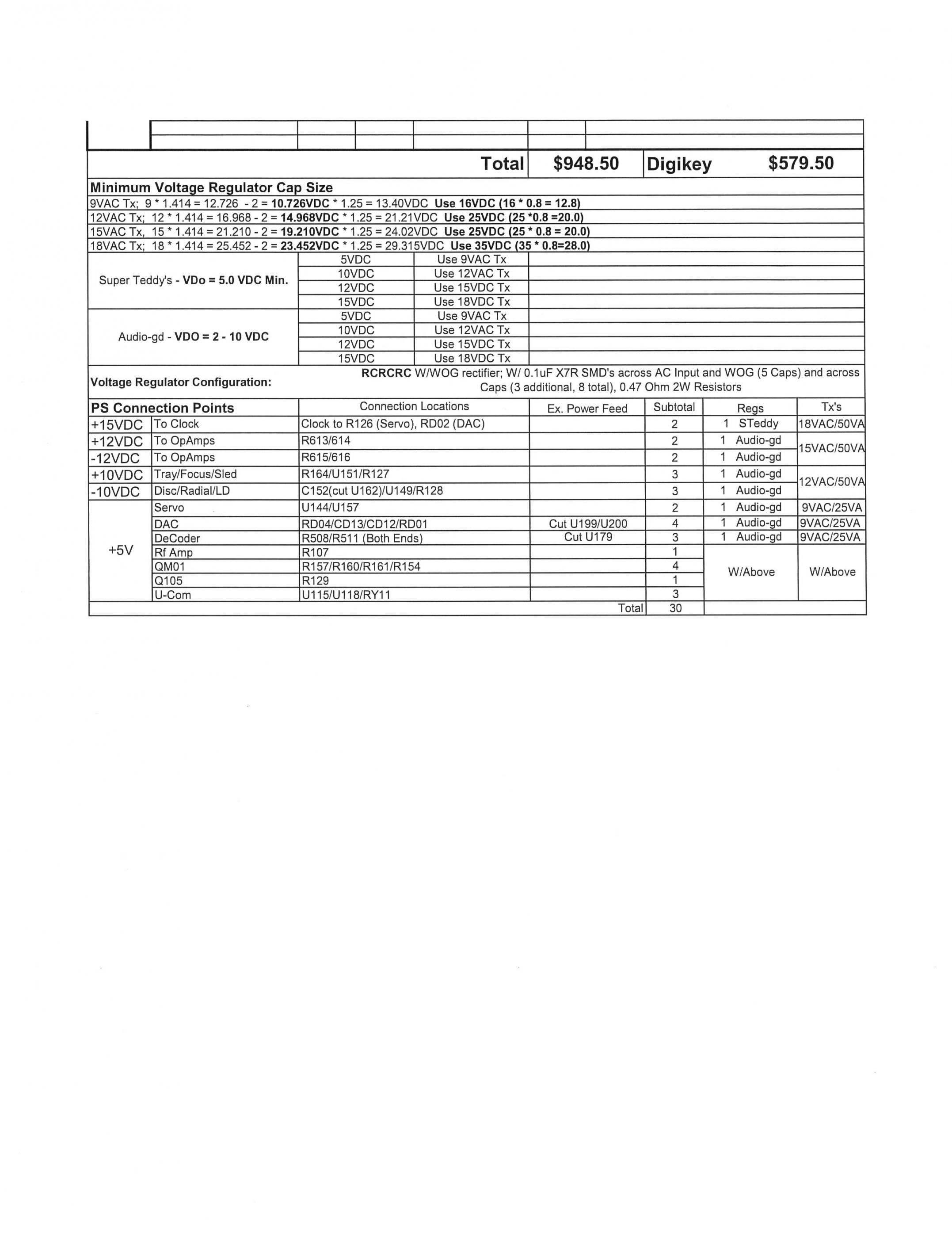

Current Power Supply Design
Here is my current design:
-50VA Tx's outside the case, 25VA Tx's inside the case
-RCRCRC filters
-SupperTeddy/Audio-gd Super Regs
You should be able to get 6 PS into the case (this will require several redesigns/repsitioning of the voltage regulators, very tedious).
- 50VA to the clocks
- 50VA to the OpAmps
- 50VA to the Laser (+- 10 VDC)
- 3 X 25 VA to the 5 VDC rails
Also, the cost add up fast. Even using chinese parts and bare pcb's, my final cost will be close to $1000.00 (without shipping).

Beautiful work in that last pic, Ian. It makes me want to start again.

Not sure that lot should add up to $1000 but it depends on the clocks and regs you are using.
Looking at the mods you have, you don't need the output caps as there should not be any DC present on the output. Also, personally, I don't like FC caps after the regs. They are great pre reg, but I prefer to use Rubycon ZLG on analogue rails and definitely no question about using anything others than solid polymer on digital rails.
What size cap do you have for the main pre 5v reg smoother. It's important to use a very high value on that rail. Also, have you regulated the servo supply because that is definitely worth doing too.
Thanks Ben. I'm sure you can imagine, it's taken some practice.
I have at least 4 totally dead players due to knackered tracks or dead chips. I've just counted 11 63's and 3 67's that have passed through my hands in 4 years! Still got 4 63's that need to get a bit sorted and sold. I guess practice makes ....well at least you get better!!!
