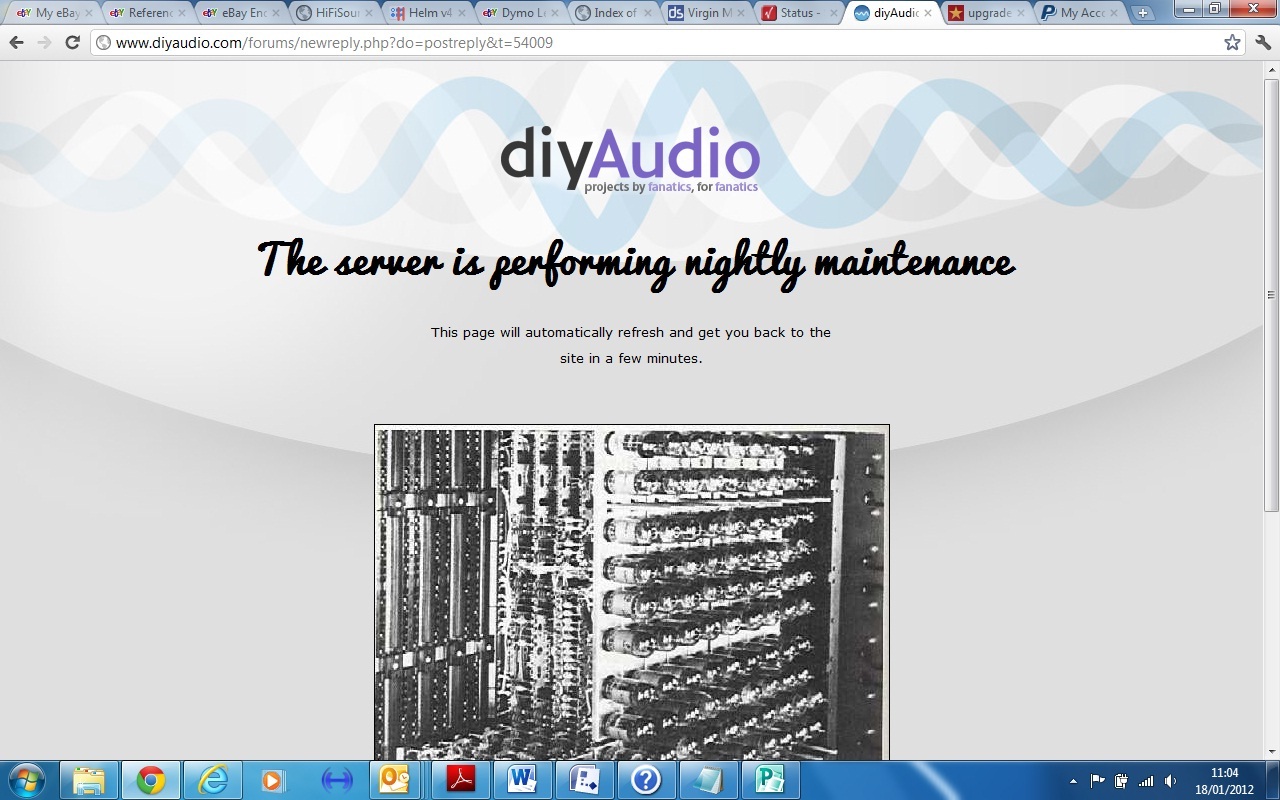

here is your answer Ben.
I cant be arsed to type it all out again.....wtf does this happen to me at least twice a week grrrrrr
