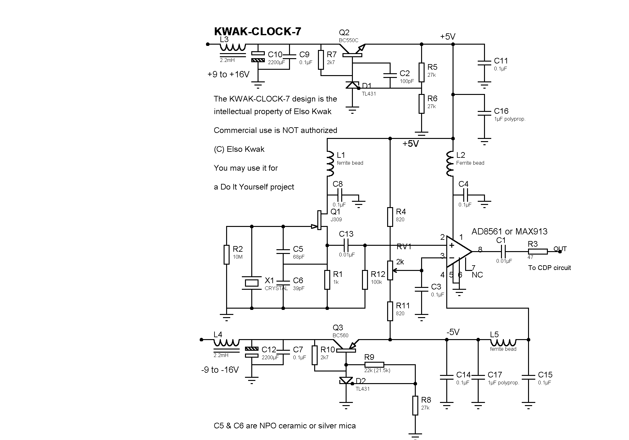

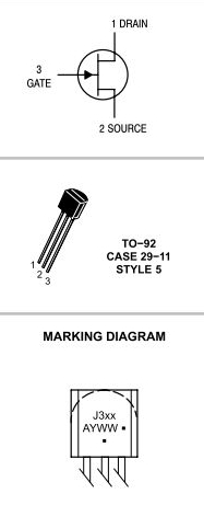

Hi chaps finally getting round to building a Kwak clock 7 (attached circuit) for my 67OSE however I wanted to double check orientation of Q1 (mid left of diagram) with you guys, I assume the Source is terminated to L1 and Drain to R1????
Tom

Thanks as per circuit then, I wasn't sure going by the names thinking source should connected to teh source rather than being the source.
(had all the parts since last May only started building it last night)
One more question gnd on the circuit is that chassis gnd or is there an 0V/gnd on the player board to connect to?
Appreciated
Tom
The 5v reg is the 7805 near the middle of the board with the heat sink on it. The pin order is In, Ground, Out. The supply smoother is the big cap right next to it, connected to the In and Ground traces. The ground wire would go directly to the pin of the cap connected to the ground. That's also the pin marked with the stripe running down the side of the cap.
