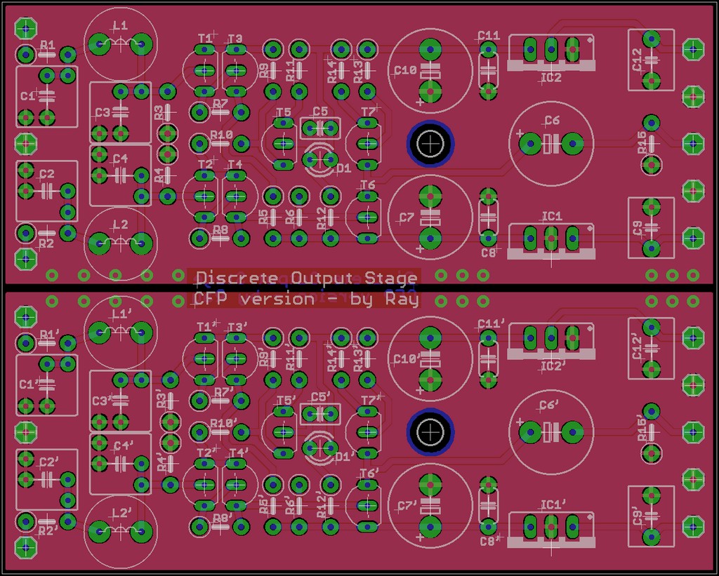

Here's a sneak preview of my new DOS board 😎
It's got the CFP input stage with revised current sink (yes, with a cool LED...) and a current sink in the output stage for improved output impedance.
It also accepts the 1% boxed-type MKP/PS capacitors now. Inspired by Steve! 😀
Ray
Ray

The new DOS board looks sweet, Ray. I hope the final PCBs are going to be red? 🙂

No the board is going to be just plain green... Boring, isn't it? But it has a Red LED! 😀
