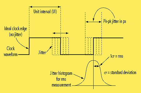

Also, what causes the jitter ? Is it anything to do with the even/odd order harmonics of the crystal itself or something completely different ?

Point-to-point shouldn't be a problem, I put my first prototype on a small piece of veroboard (photo is on my website). It's such a small circuit, you could even build it inside a HDAM shield can 🙂. Use the can as ground and solder away!
The causes of jitter are multiple. If there's noise on the power supply of the oscillator, this could penetrate into the clock signal because the PSRR of the circuit is not infinitely high. There's also thermal noise in components that causes the waveform to deviate from the intended point in time (unit interval or UI). Jitter can also be caused by reflections of the clock signal in the connecting cable or wire. These reflections will 'bounce back' and influence the original signal, creating deviations in time.

Yeah, makes sense. Could the PSRR be improved ? What about thermal noise ? Does component choice become critical at this point ? Also the connecting wire ? Any solutions/ideas ?

The CD clock's oscillator is a single-ended design which is more sensitive to supply-noise. The circuit already has L-C decoupling of the supply lines. Separating the supply for the oscillator and the comparator will bring some gain. Improving the PSRR further basically means choosing an other circuit. The supply itself is not the lowest-noise, so that could be improved as well. But then it will stop being a simple circuit 😉
Thermal noise can be reduced by submerging the clock in liquid nitrogen 😀. But by using a low-impedance design, the noise can be reduced as well. Low value resistors generate less noise than high value ones, for example. Also, the capacitors are important. Ceramics are known to be microphonic, so it's best to use NPO/COG or polystyrenes.
