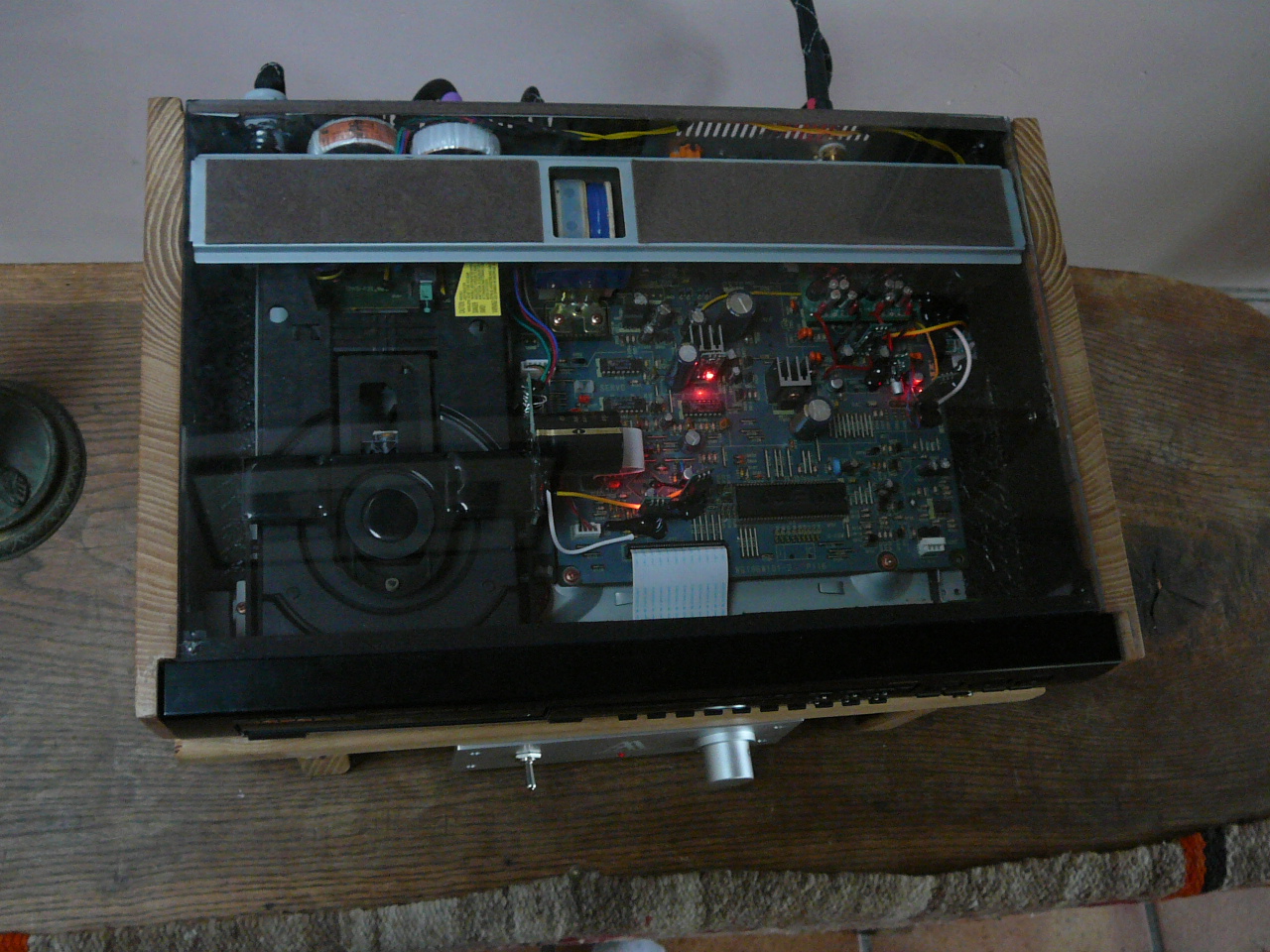

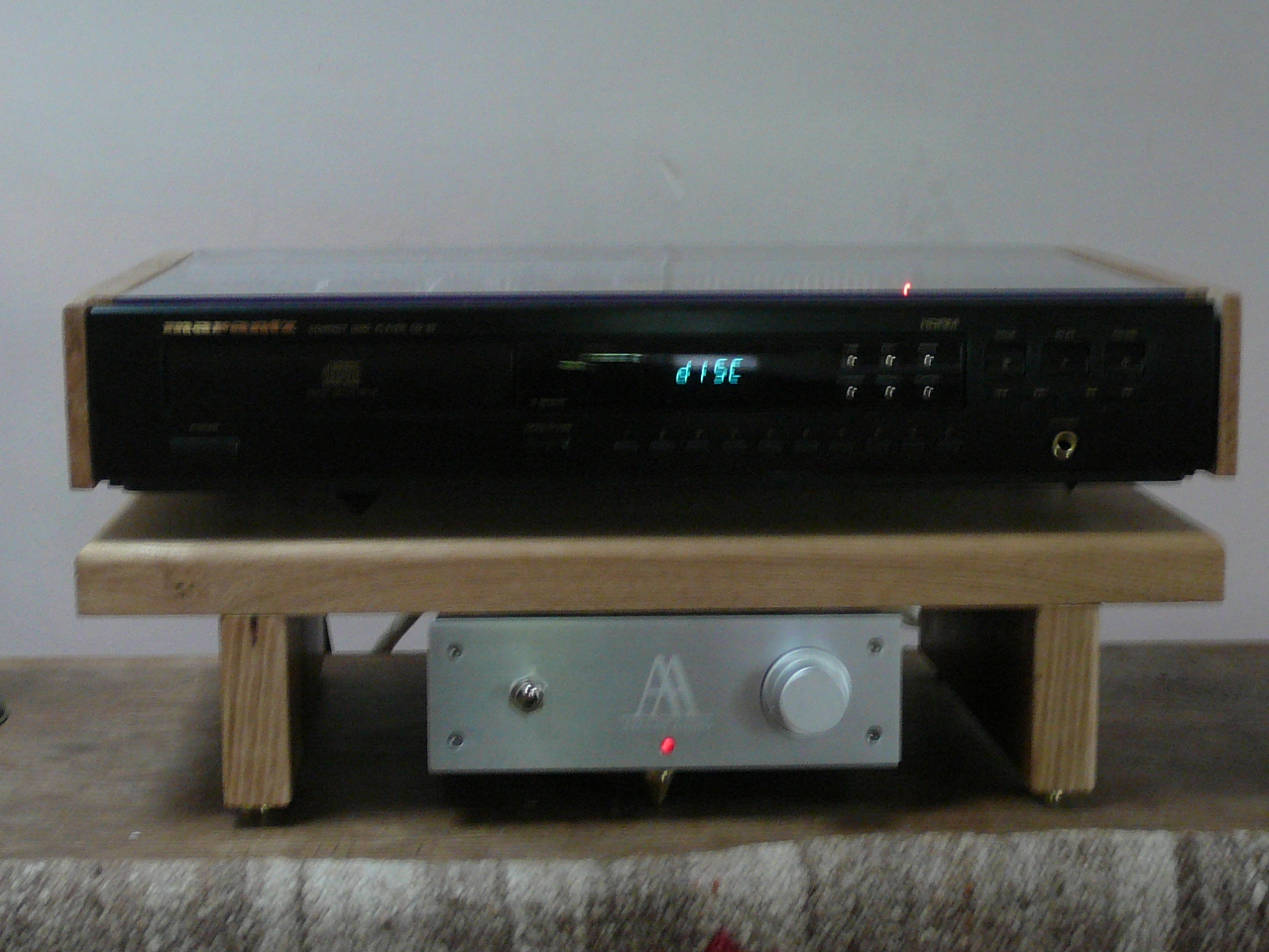

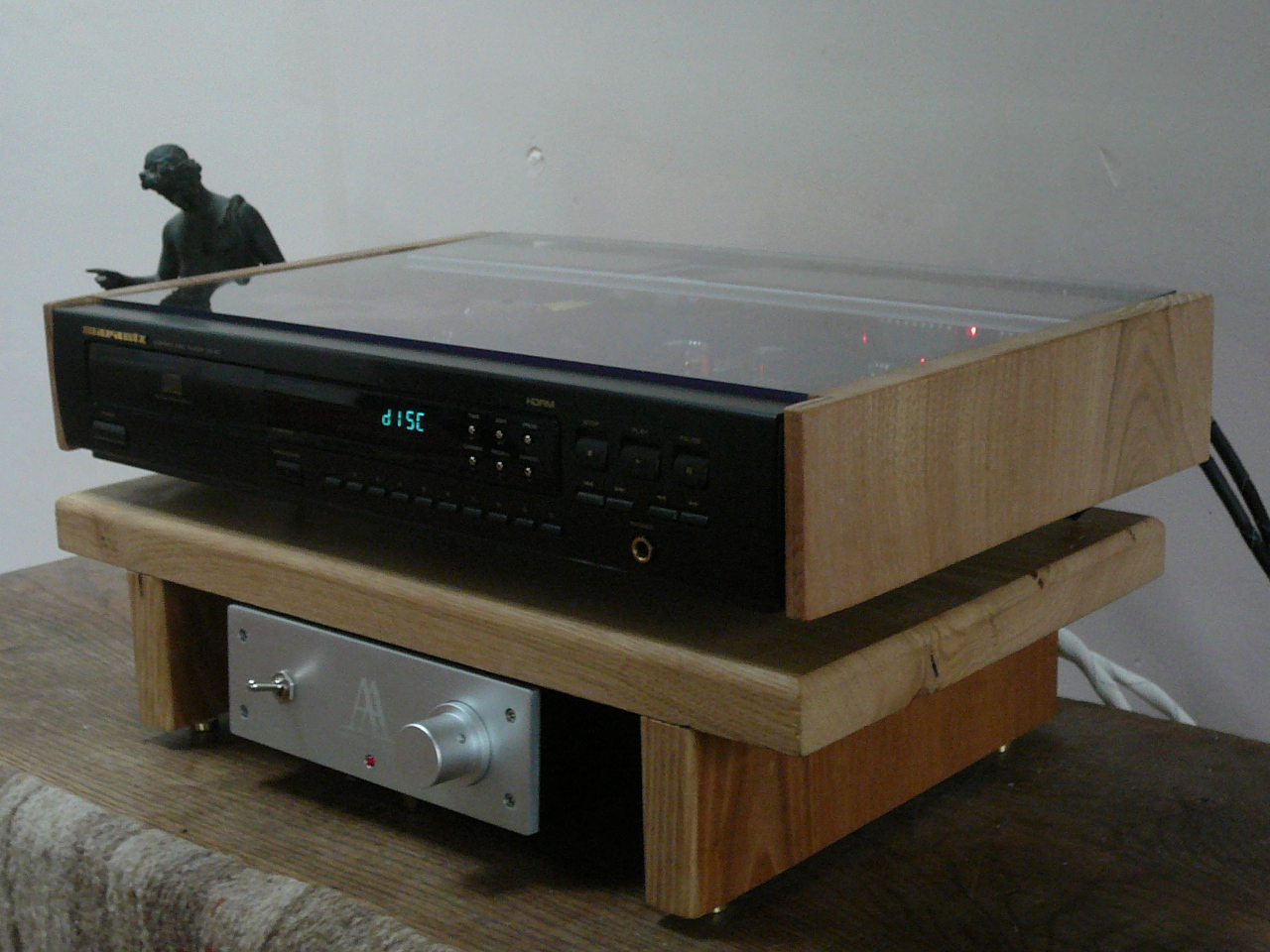

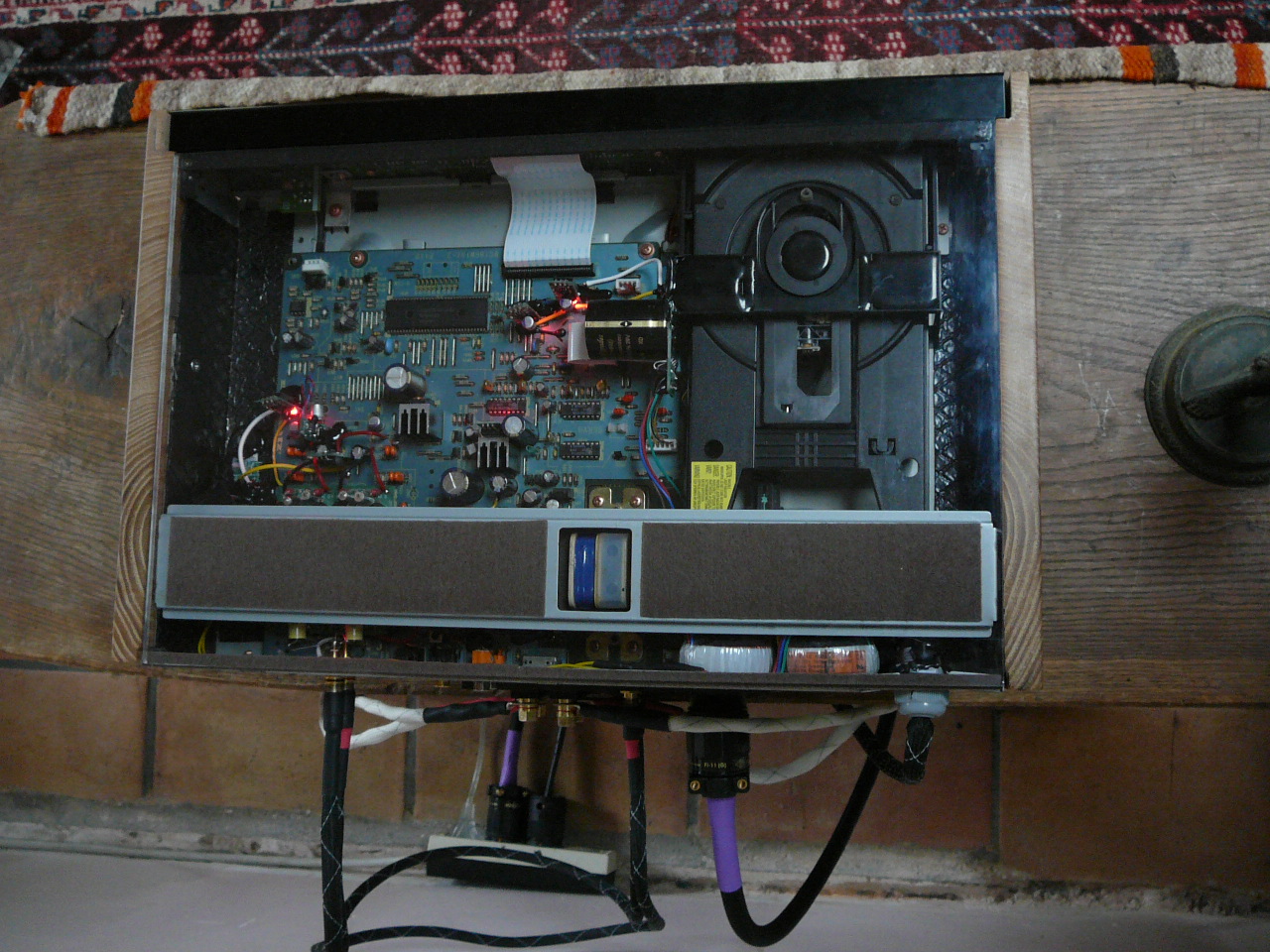

As promised, my hot babe in new outfit. Rather dark day so the photos are not great.

Thank you sir. You nailed it. That was the look I was going for, with the modern touch of the Lexan. I still remember those old Sony's and Marantz from the 80's. They were gorgious.
The Black hot glue is everywhere in my machine. It's almost impossible to remove so be carefull where you get it. As you can see from the pictures, somehow Brent managed to get a perfect circle of it on the puck as both additional mass and I suppose damping. I mean perfect (and intentionally).
