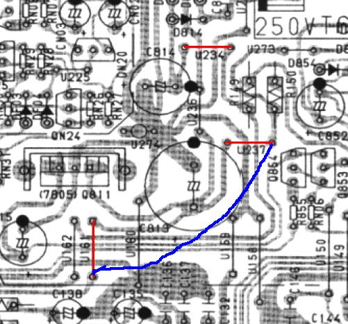

Still difficulties with the driver regs, it's not a mod for beginners apparently. I tried to reverse 2 of them so they would be in same line as the pictures from Brent's cdp. That didn't work. The transport went mental! :gnasher: So I got all the regs out. Nothing. 😱 I thought I fried the player!!
After some poking around with the soldering iron it played again! What a releave!!! And it sounds much better than with the regs! (except for the bass) Promised myself never to do any mods again if I got it working again. But that was an hour ago 🙂
Now I'd like to try the simple driver regs mod. I found this picture, but I couldn't find a complete instruction. Can anyone help me how do I install the 7808/7908 and where? I wanna make sure I do it right this time... I kind of mis the nice bass.
Find the post of Glenn from wich this pics is from, I think it was with instructions. The regs go instead of U234 (7908) and instead of U237 (7808), in on the big cap side, out at the right side of the drawing, ground on the top ground plane or if you can with a wire to U274, on top between the big caps. Remove U161 and add a wire like the blue line.
Done.
Wonder if a cap is needed on the output/gnd reg's pins, or not.
The low CD54/43 guys advice: LM340 AT 5V at the main 5V reg, styroflex cap 2n2 IIRC, at decoder HF input.

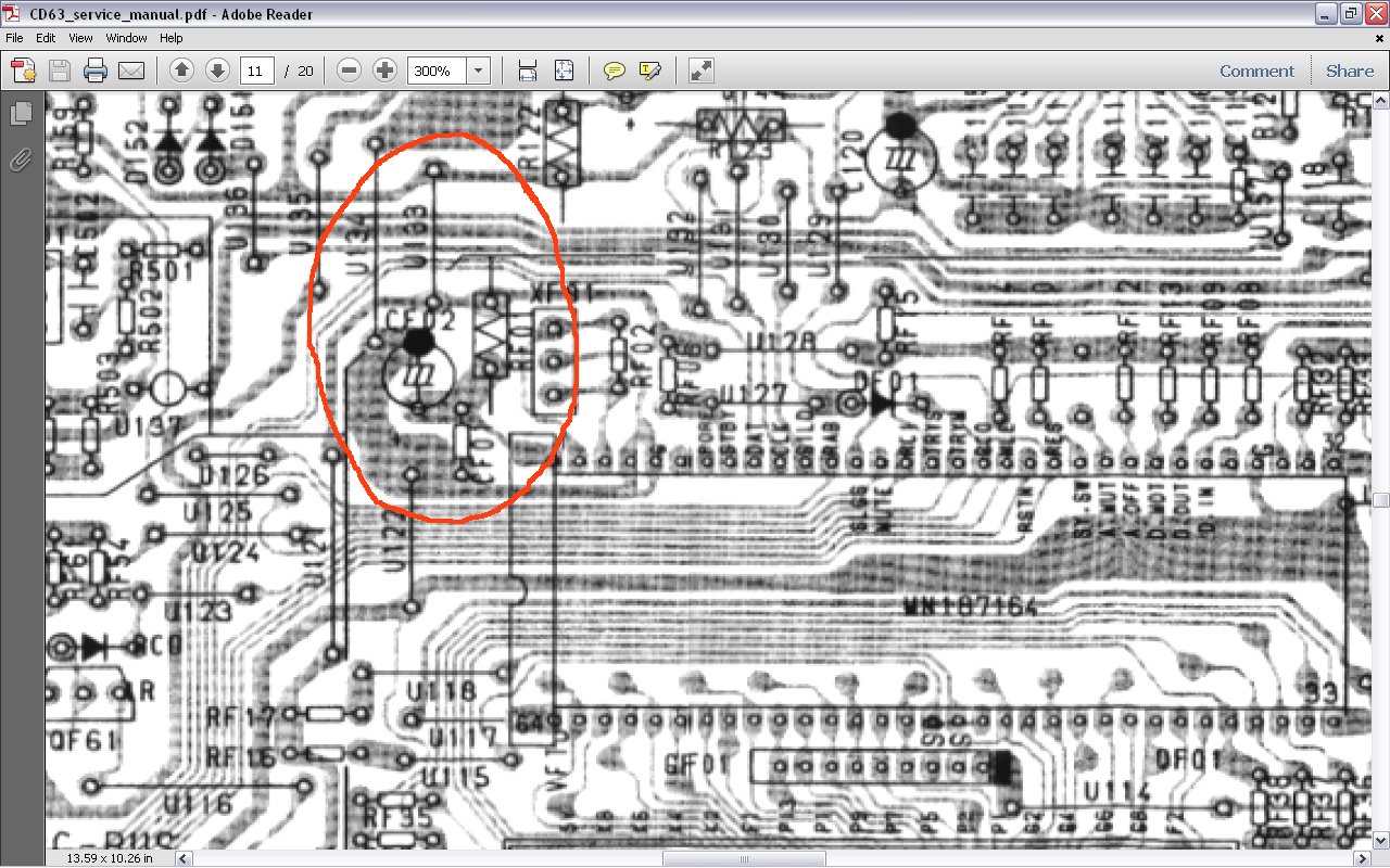

I cant fully remember how I did this on the 63 but looking at the layout Im pretty sure I removed U133 and fed RF01 with a new reg.
I do this to all CDPs now.
U133feeds the processor and the front panel if my memory is right.
Without looking any further, it does look like there is other stuff supplied off that link u133. I would just remove the resistor the drop the out pin of the reg through the hole closest the cpu. The middle pin can be soldered to the top side screen and the supply pin wired from an unregulated feed from the main psu.

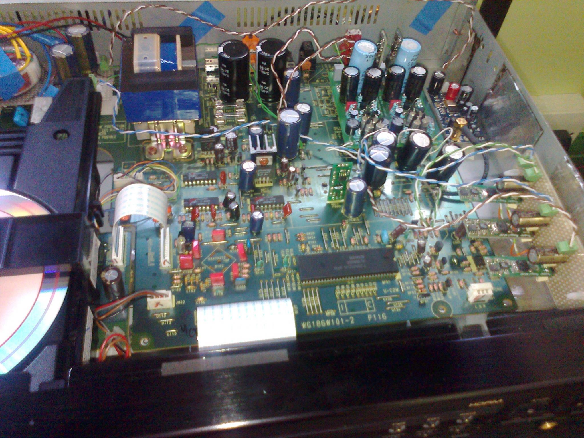

Finally got round to dossing my 67, only the earlier version though.
Not the neatest job but on the plus side it worked first time.
First impressions weren't great, it seemed a bit muffled to start with but it seems to be getting better after an hours playing. Hopefully it will continue to improve. Odd though, as the caps were all in use in the player before.
Pete
