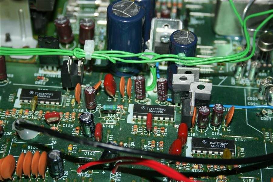

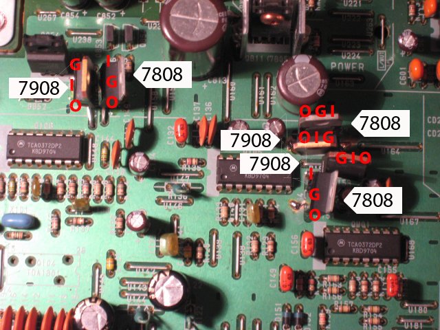

I used 3x 7808CT and 3x 7908CV
Btw: the player makes a strange sound when powering off. The laser slides back on the rail and there's a distorted sound over the speakers. Wasn't there before. Maybe that gives away a clue? 😕
Can anybody please check if I did install the 8v regs the right way? There seems to be a difference between my picture (on the left, before putting in the new caps btw) and Brent's (on the right). Can't figure out what I did wrong though (I put the output towards the ic's)
Can't comment on the regs as I haven't done that mod myself.
The noise when you power off is probably due to removing the muting circuit (I assume that was a mod you did?). It's normal, just turn the amp off first (or turn the volume down).

If it works it can't possibly be wired wrong. The sled moving is probably just because you've changed the power supplies and so things shut down in a different order to before. I've noticed some odd things like that, especially on my Arcam Alpha: when I switch off the laser smacks into the stops hard. Good job I only power it off when I leave the house for a few nights.
The sled is moving one way on power down as one of the v rails is holding a charge longer. Are the main smoothing caps equal in value etc

The sled moving like that is not normal.
It's very simple: just measure the supply-voltages at the appropriate pins of the driver IC's. If all checks out (+/-8V) then you're o.k.

Tnks for the reply's. I used these for the power supply:
C803/804 Panasonic 10000UF, 35V TSHA
C813/814 Panasonic 22000UF, 16V TSUP (had to put one on a printboard to fit it in)
C815 Rubycon ZL 6800UF, 6.3V
C805/806 Panasonic FM 2200UF, 16V
Also changed the smoother caps to Rubycon ZL 330UF, 16V (+bypass caps)
Played them for +100 hours now but still the players sounds very flat (bass is quite good though). So I suspect I did something wrong with the driver regs. After I installed them the great sound was gone.
