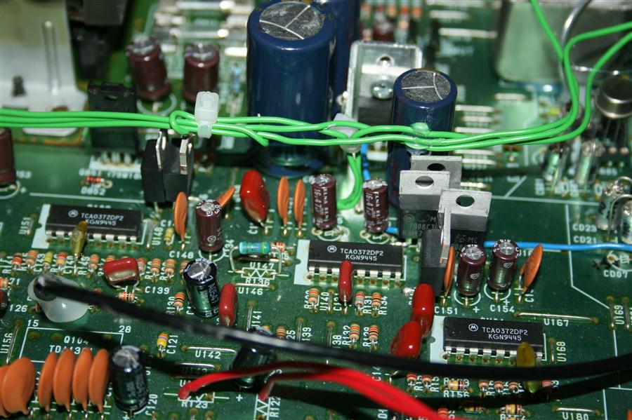

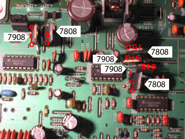

Hi guys, got the part from Farnell and did some more modding esp. to the power section (the big panasonics caps) and the decoupeling caps for the drivers (C153,154 C135,136 & C146148). The bass is now quite allright, but still got problems with the flat sound I mentioned before. After putting in the 8v regs at the driver ic's the magic was gone. Even now with the lm4562 in place there's no air, depth and it sounds lifeless. So maybe I did something wrong?
Can anybody please check if I did install the 8v regs the right way? There seems to be a difference between my picture (on the left, before putting in the new caps btw) and Brent's. Can't figure out what I did wrong though (I put the output towards the ic's)
Tnks!
