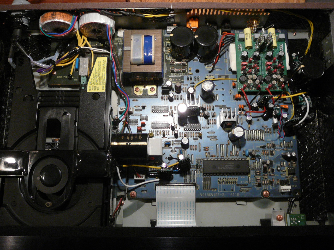

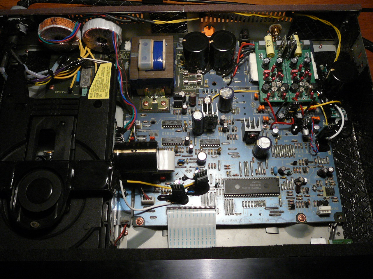

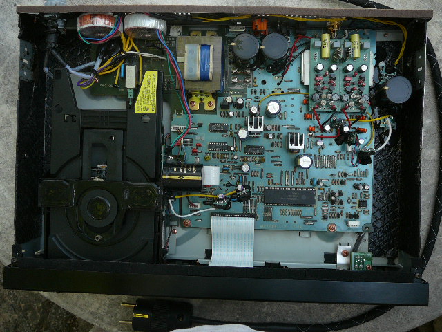

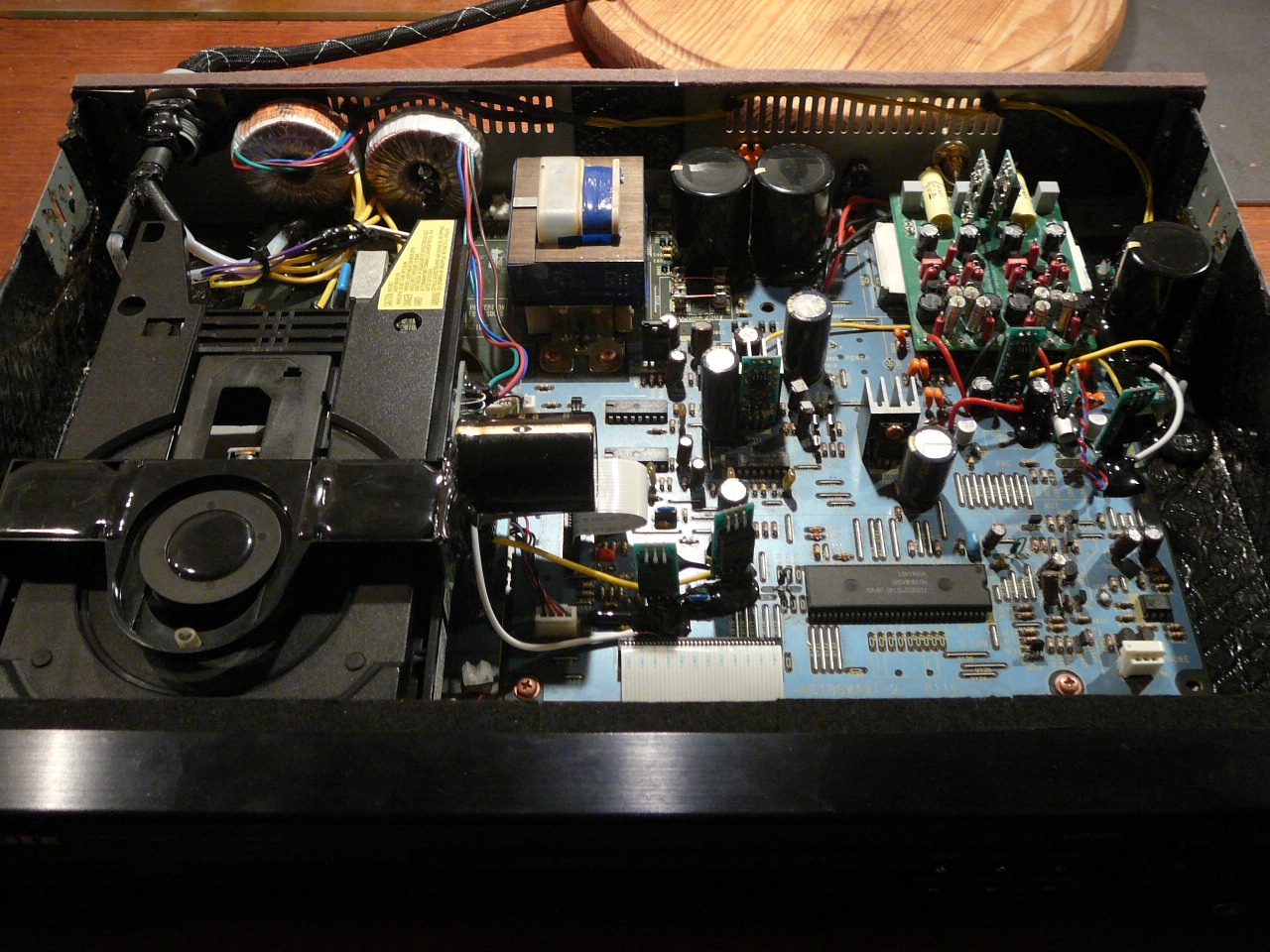

There's a limit! Money being one. I have sent the player 6 (?) times to Brent, from France to the UK. The time before it got pretty badly banged up in transport, so there's that to consider as well. Sometime this year I will cross my fingers and send it for the C2 clock and anything else that Brent thinks will be usefull. I think Mal. you were asking about the big caps? They are the Muldorfs that Brent has had made... "Si" on his site. If I were going to have a resistor change it would be for the Vishay S'foils, which are in my amp.
If someone wants a C1 clock, it will be up for grabs when I do the C2 change-over.
I'm making some final udjustments to the wooden cheeks and will post pictures when it's all back together and looking purdy. It may sound dumb but the cosmetic change seems to have a psychological effect on how I perceive the sound! I also added a lot of mass by glueing lead sheet to the bottom and the case is more ridged with the wooden cheeks (which are screwed on).
