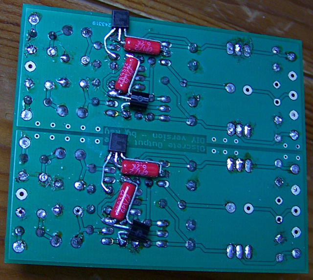

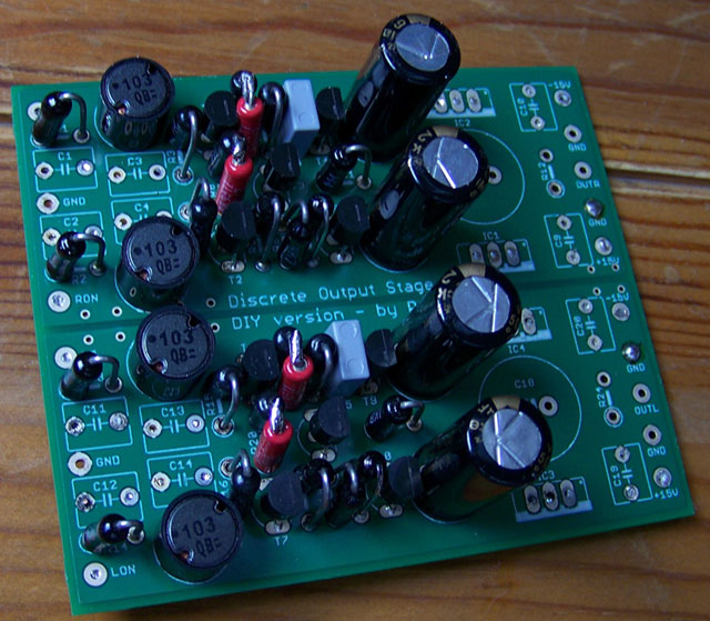

Hope to get my output stage with the complementary feedback pair back in the player soon! One step forward, one back...
Cut 4 traces under each 6.2K resistors, added a 91R to the 820R to get to right value on top of the PCB. I wish I have the new PCB but that should work as good, even if does not look that good. And yes, how much I wish I did not try to change the Styroflex sheild's way... stupid!
Yes? Even my skills in styroflex destroying while trying to turn them? 😉 I need to wait for my new parts from Pcx to come for impressions, sadly. Stupid me.

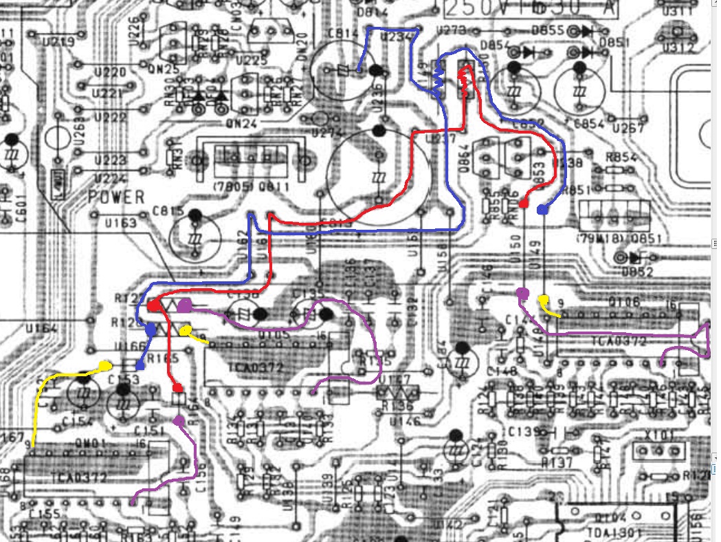

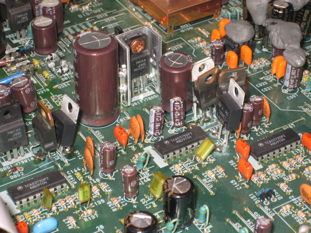

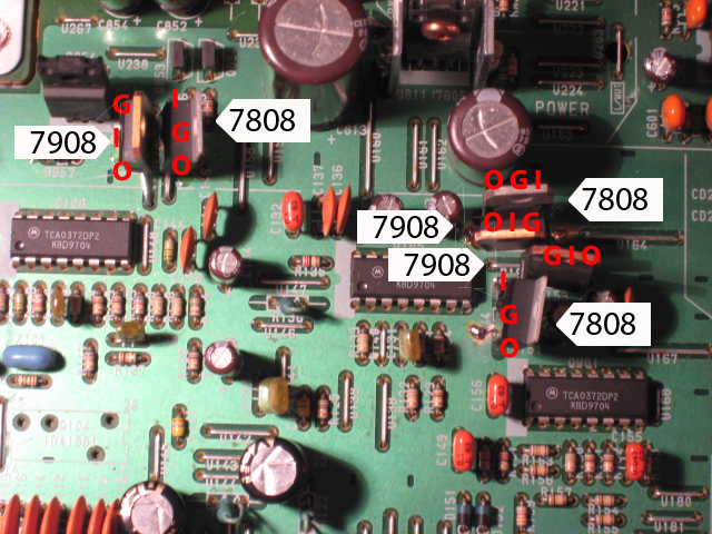

Hi, I put in the 8v regulators on the drivers ic's. The bass is much better now, but for the rest it sounds very flat and lifeless. There's less detail and I have the impression that some instruments in the music are almost gone. Is that normal or did I do something wrong? Didn't install the new caps yet (they are still in order).
I noticed some difference in the pictures of the pcb foto's on this forum and mine. I checked the schematics on:
http://www.diyaudio.com/forums/digital-source/54009-marantz-cd63-cd67-mods-list-1578.html#post2474211 (see attachment also)
It seems that I connected it accordingly (output's to the ic's). The picture shows how I connected it. I removed r127/128/164 btw.
Did I install them the right way?
