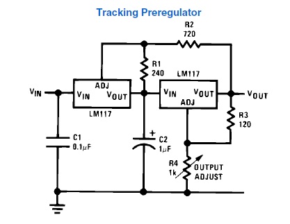

And as Martin Clark will probably point out again, you can make a tracking pre-regulator to improve a 7805 or super reg etc.
Just like this one! Although tbh, if was going to that much trouble I'd build something a little better!!
Yeah, but that's half the point: for less than 1euro you can approach 100dB ripple rejection if you want.

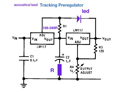

Replace R2 with a red LED and C2 with 1uF+2R7 in series (or 100nF +10ohms if you like) and it'll perform even better noise-wise. Not the ultimate, no: but dirty-cheap, and very effective.

Not certain about the position of C2 refered to above. Why does the LED and small cap/resistor inprove on the ripple rejection?
cough, like this:
It's the tracking pre-arrangement, not the minor changes that makes for good performance. Look at how it's arranged: the first 317 ensures there is *no* ripple voltage appearing across the second, in fact the second reg sees a constant voltage difference across it regardles of whayt the load does. So the second reg applies all its gain to load regulation, while the first deals only with the ripple/noise on the input. This is a subtley, but it audibly improves on just using two regs in series.
So - my suggestions are using an LED voltage drop to set c.2.8-3v across reg2, which absolutely minimises noise from the first reg (because the led at 5-10ma has a dynamic impedance of only c.20-30ohms). The added resistor(in blue) critically-damps the input to the second reg, stopping any spurious oscillation due to high loop gain / layout strays. Use 10R with C2 = 100nF down to a min. 2R7 for 1uF, or 1ohm with 10uF.
A circuit well worth playing with for the very low cost of entry.

RCruz - not necessarily. A tracking reg arrangement requires about 5-6v minimum headroom or 'dropout' voltage from input to output, whihc you may not have. A good shunt reg uses a current source to feed the load anyway, so what it upstream should be fairly irrelevant. If you want to add anything, a little RC decoupling before will help at high frequencies when the active current source starts to become less effective (but a little RC ahead of most regs is rarely a bad idea IMO!)
