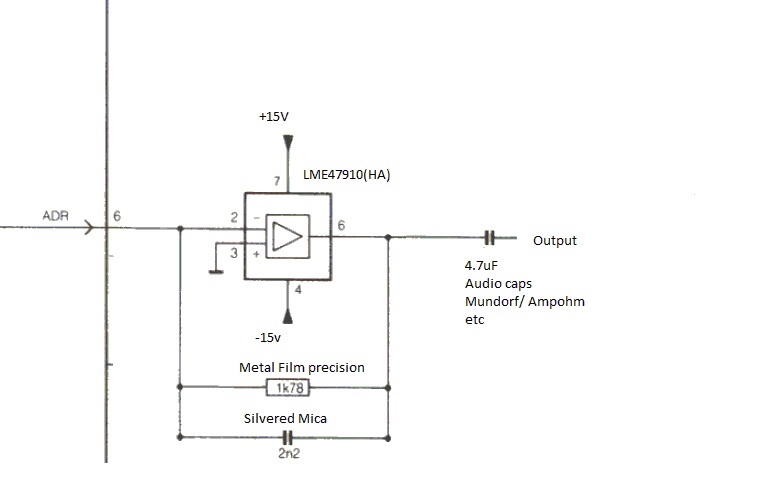

What output stage are you using for this dac?
Not 100% decided yet! I've run several types on various incarnations of 1541 output!
I have a resitor IV into a tube stage option that I got at the same time as the other PCB's in the pic.
My CD960 currently uses a single burson IV with a feedback filter and an adjustable CCS to offset any DC on the output (removing the need for DC blocking caps on the output)
I really like the fully discrete, zero feedback with a DC servo (again removing the need for DC blocking caps on the output) used in meridian stuff.
What I'll probably do is use a basic opamp IV (single ended with 1.8k and 2n2 feedback) and DC blocking caps to start then when I've built the tube stage, have a go at that but if I'm honest, fully discrete zero feedback is probably the way that I will go! I know Simon and Lee have had some really good results with Pass Labs D1's and if i'm honest, i'll end up having a play with that too>
Attached is a basic opamp IV which will pretty much outperform anything you'd find in a comercial player (unless its discrete!) If you add a ccs before the opamp, you can tune the DC voltage to 0 then remove the blocking caps and then you are starting to talk......

Same here, I will try the tubizator one, but will probably end up with this http://bgaudioclub.org/gallery/albums/userpics/11518/discrete_I-V.pdf, powered by another 3 salas shunts (so that means 7 salas regs in the dac).

Hi ricardo, here is something I've yet to hear make a decent sound!
