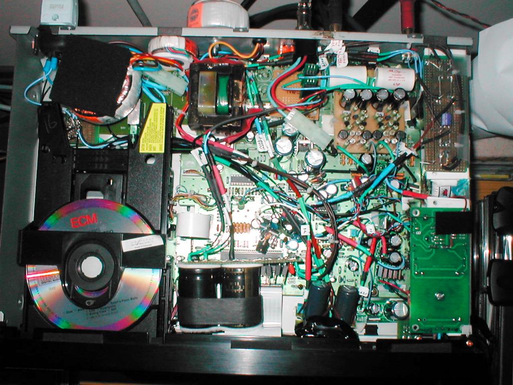

I have already heavily modded the CD17 🙂
Bigger PSU caps.
Oscons in the right places
Bypassed the HDAM modules
Removed muting transistors
Changed output coupling caps (yes I realise I could omit those but I was reluctant to do so)
Next step is to replace the NJM2114s - but I need to pluck up the courage to remove them (they are surface mounted). It would be nice if I could find an adapter to change the surface mount to a standard DIP socket.
I may try and solder a socket in - but I think it might lift the tracks....
And now, for those that did not see my last mod, here is the DOS output bypass:

Yes... that is why I stoped modding.
I stoped before I could regulate the drivers, do the coax mod, regulate the transport section, replace the cap before the main +5reg by a bigger one...
Now I am colecting inspiration before I do the DOS revamp 🙂
It is quite complex because I have 6 TX inside, feeding 9 separated PSU.
Of course it could be done but it would mean a LOT of work and probably a lot of tears.... This old PCB is already too much reworked.
I would like to start over from the beginning using a fresh untouched "pacient" ....
Knowing what I know today, I would do first things first 🙂
