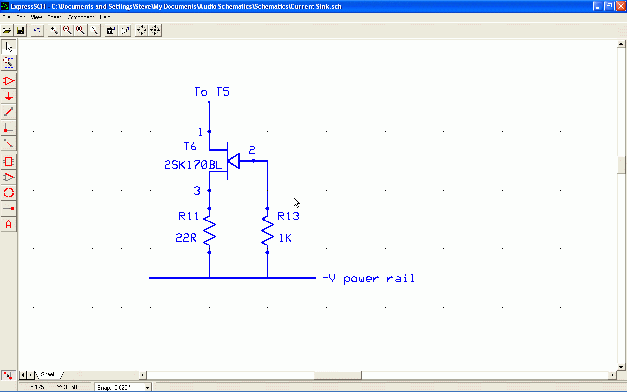

"In the buffer I have added a current sink, replacing the 1.8k resistor. This is an addition of another 2SK170BL and a couple of resistors."
I do not see this current sink in Ray´s schematic.... can you please elucidate ?
I do not believe this board can fit inside my CDP.... can I mod the existing DOS ?
Hi Ricardo,
The DOS-CFP page is still under construction, and the schematic only shows the added transistors in the input stage, which is the essence of the CFP version.
The 1k8 resistor may be replaced by a current source. It was added later and can be applied to the original DOS circuit as well. I hope to update it soon with some text on Steve's new board and I will put up a specific schematic of it.

What should be the advantages of such CCS ?

FWIW,
I added the current sink to my board before I ever heard of the CFP. It didn't make any difference. The CFP makes a difference.
Steve
The input stage and output transistor are directly coupled, so any variation of the input stage current will have an effect on the operation point of the output transistor. The current source makes the operating point of the output transistor independent of the input stage. It will set the current to 10mA, whatever the input stage does.

Allready done, check THIS , Figure 15A/B/C and Table 3. And with 0.1mA through JFET's they don't know if they are barely alive or barely dead 😀
Yep, that's also my conclusion, thanks for the link. I did some simulations today, and mainly the second harmonic is noticeably lower when using the FET current sink instead of the 1k8 resistor. Third harmonic was only just a bit lower. Current was set at 10mA, but if you use a trimmer in the current source, all options are open!

I have got 2sk170BL ranging from 6.5 to 10mA Idss.... What should I use there ?
If you want to set the current at 10mA, the 6.5mA is less suitable. Idss also depends on Vds, but it's unlikely it will do 10mA, even when the source resistor is 0 ohm. You have to experiment a bit. Just insert a 22 ohm resistor to start with, and tune it lower if the desired current is not met. You could end up with a wire, but that's o.k.
