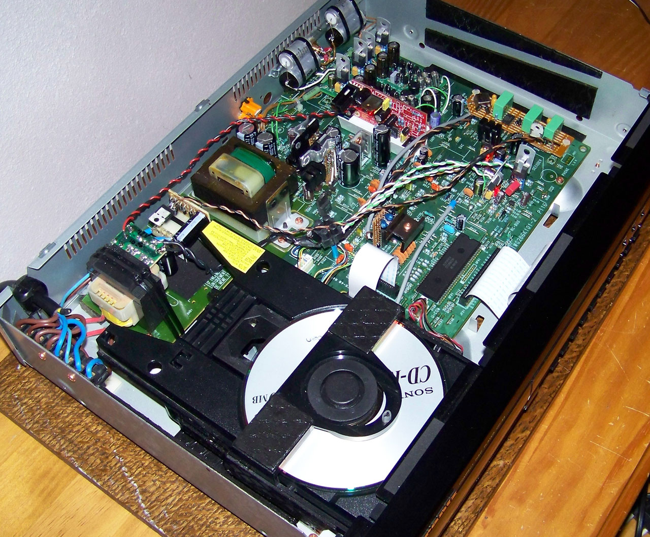

after having fried a poor TDA1541A and noticed prior to this sad end a warm top lid on that player I'm know loosing my sanity finding the CD43's top lid warm also :'(
Is it the case of yours? My cheap thermometer indicates 34°C, wonder how much the air and parts are inside... maybe I'm no more sain a long time ago, maybe when stock a CD-43 still runs warm around TX... or not...
Do I need to rush to the plug prior to house's fire?
How did you manage to do that? 😕 The good old 1541 draws a substantial amount of current, so it's normal it runs warm, just like the SAA7220. Now you are seeing ghosts in your CD43 😉

In fact no proof It's fried, with 3x super regs around it, almost "on" it to be as close as possible, a thick plastic box and just the top lid and a part of bottom of metal, heat from SAA7220 and SAA7310's regs, heat from the yet tiny discrete output... then a badly reclocked and unstable TDA's BCL clock... wich leads to more heat I've been said... then it started to unsync until no sync at all and now, even in factory form, dead silent... the only way to be certain is to fit a new TDA :'( the expensive way... or plunder the 40 to fit in the 43...
As for the CD43, I've investigated, heat mainly comes from the DOS' regs and regs voltage drop around as my 5Vs are on a 16V PSU. I have a 12 near, may replace it. The proximity of the amp in normal condition and the wamed wood furniture does not help...

As for the CD43, added heatsink on DOS (oops, see that small package... my mistake) and on reg on the super reg -wich is very close to lid and made that "hot spot"-.
Changed that 15.5V PSU, feeding 5V regs, to the 10.5V one, added a spare cap. Defo worth the 4.25€ put of the CD43 😉

I harvested the TDA and SAA chips for the DAC from a CD40 I found cheap here 😀. It didn't have many hours, so I saved the CDM mech as a spare for my CD72.
Does the original tranny in your player also get too hot? If so, it could be mains related in your case, and not caused by the load. If everything is humming this is an indication of distorted sinewave or DC components on the mains.
As an experiment, you could try a DC blocking circuit in series with the player's mains. It is basically two big caps back-to-back with four diodes in parallel to prevent voltages get too high. If the humming stops, it's DC. You can find an example of this circuit in the Balanced Mains Filter PDF on my site. WARNING: mains voltage can kill!

yes that CD40 PSU also get hot as the ones in the CD43. And the new TX in does humms so much that's almost a bzzzzzzz... endless issues ! I've tried to hold it between fingers: the main CD43's PSU, wich is a bit thermally linked to the lid via copper covered screws, is hot, the "in air" new buzzing TX with no radiator nor link (may put a piece of aluminium on one of the iron's side), this one is hotter, I guess hotter by 5/10°C will be hard to hold in hand.
I'll the CD40 on stop for a couple of hours and check the TX heat. In this one only the Flea's TX added, all my regs were fed by the factory's TX. On stop load may be few, heat there will defo find a faulty main.

CD43 seems cooler, a bit, just a warm spot on the lid around the drivers's regs, the hottest of them all, then DOS. Other with less voltage drop are fine.
As for main/hum/heat issue, the CD40 TX is hot, hard to say much as touching is not easy because of plastic surround, and the only TX free is very hot, it's the Flea's one. Does a Flea driving 2 logics burn that power? Same as the CD43: TX mechanically linked to player (ground, lid...) are hot (45°C?), TX free of contact are very hot, (50°C?) more or less humming.
As for the TDA1541A's reg, they all run very very hot, even with no music. Guess a fried IC does that :'(
