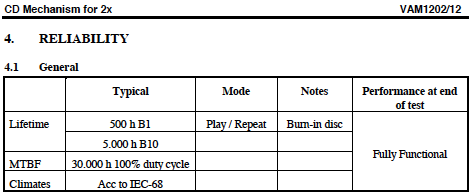

Look at the VAM12 reliability table, scaring! 1% won't go over 500H, 10% over 5000...
