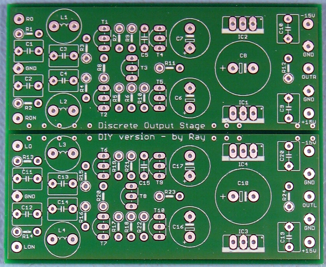

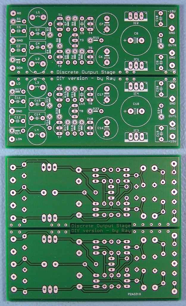

Due to multiple requests over the past few weeks, I decided to do a small production run of my DOS PCB. They are not as dirt-cheap as the Flea boards because of the small batch size, but for €14.00 ex. shipping & PayPal, you can be the proud owner of a stereo board!
The PCB holds two identical sections for left and right channel. They can be separated mechanically with a PCB cutter if desired. Ground planes for left and right are also separate, but can be linked by jumpering a number of via's. The circuit is identical to that on my website. The schematic and partslist can also be found there.
If anyone is interested, drop me an e-mail at
dospcb@raylectronics.nl
Ray

Another very tidy looking board Ray! How many boards did you have made? i'm wondering about the set up costs for a small PCB. Ian
