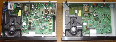

Well seems I have to work guys!
Sounds so metallic no way for me to listen to it in this state. Marantz have pushed the downgrade to far... Maybe the even-not-Elna's super mini and cheap caps at op amps have passed away...
Color and size of TX is the same as in the CD-53, hope it's not smaller, the mech ( original CDM12 ) skips ( grease on mech's radial movement is brown... ) and the display is already dimmed wich means used a lot ( my very first CD-53's one was almost off... on 20h a day... and 2 mechs used! ) so I don't believe the mech can be saved.
No remote back switch, no remote parts on pcb ( controller side ) and HDAM it's parts already removed for me Marantz do you have some "ICs only" mounted PCBs?
Strange thing, it's a MkI (no CD-43 MkII I think) and it does have the caps in DAC to Decoder's clock feed.

I happen to have an old Phonosophie CD Player (based on the CD63). It looks like the CD63 with a Phonosophie label on it.
Q: Anyone know what mods Phonosophie might have carried out on this machine. I sounds smoother and warmer than a stock CD63KI. Almost like a "63KI on tubes".
Also I open the cover and the copper CD63KI is absent so obviosuly this is a CD63 modfied and not a CD63KI. I happen to have access to an old CD63Ki chassis (lens not working) and can canabalise the CD63KI for parts as well.
