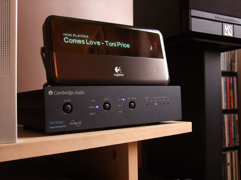

Hi Ricardo,
I decided a while ago that a hard-drive based solution was what I wanted. I know that with the right equipment some of these solutions can scale dizzy heights, but I thought I'd start at the bottom.
I ripped all of my CDs as lossless FLAC files, using EAC (Exact Audio Copy) in secure mode, offsets corrected, using my PCs Plextor drive. This means I'm guaranteed to have bit-perfect files. I wanted to do this anyway, so that I could keep a copy somewhere else in case of fire, robbery, etc., I wouldn't lose all my music.
I then bought the Logitech Squeezebox Classic (£150) - this is the SlimDevices Squeezebox 3 rebadged as Logitech bought SlimDevices.
This connects to my PC over my wireless network. The PC is running server software called SqueezeCenter in the background.
You can instead run it on a NAS drive which you leave on permanently, if you don't want to have to switch your PC on to listen to your music. I don't mind as my PC is in my bedroom so can't be heard in my living room, and it's hard-wired to my router so I can use Wake-On-Lan (WOL) to boot the machine from my listening position and a plug-in to shut it down again (I haven't tried that yet).
The Squeezebox itself is the interface, it talks to the server which streams your FLACs to it. Its own audio output is quite good (uses a Burr-Brown 24-bit DAC, PCM1748) but is a bit sharp and thin straight out of the box. I replaced the switching power supply with a transformer-based one and things improved, it got much smoother. Many (most?) would be happy with this sound alone.
I chose to feed the coaxial S/PDIF output to the Cambridge Audio DacMagic. This upsamples to 24-bit/192kHz and has twin Wolfson WM8740 DACs in dual-differential mode (used in CA 640C/740C, Rega Apollo/Saturn, some Arcam machines). It also has different digital filter settings, selectable via a front-panel switch. The manual even shows ferquency and impulse response plots of what they do!
Most seem to prefer the 'linear phase' setting, but I think I'm leaning towards the 'minimum' setting, which trades some phase error for no pre-ringing in the impulse response, for what it's worth. Linear seems crystal clear but perhaps a bit clinical. Minimum trades a little precision for a bit of warmth and ambience. It's nice to have these settings as - contrary to some claims - there IS a difference, and maybe some music sounds better on one particular setting. There is also a 'steep' filter which sounds a bit softer to me but could sweeten up low-bitrate signals. If you hold the filter button in, it inverts absolute phase too. Not sure if I can tell the difference on that one yet.
The wall-wart is just a transformer (12V AC) - the rectification, smoothing and regulation all happen inside the DAC case. There are balanced and unbalanced analogue outputs.
It all sounds very nice but I don't want to post any conclusions yet - it's all still burning in.
