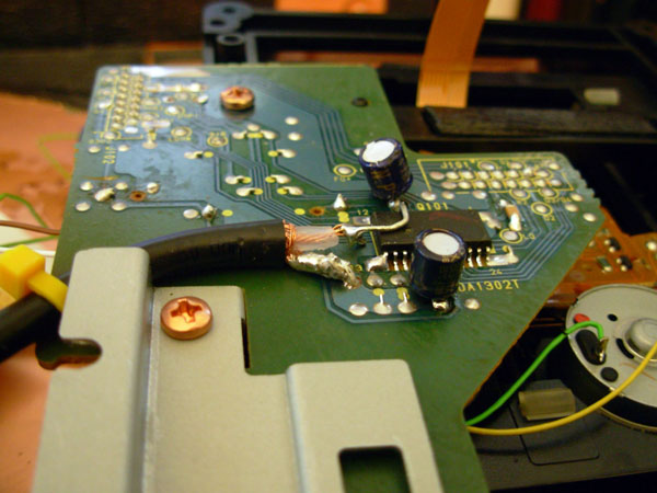

Hi Brentrowemeister said:
Cut the track near U100 fo the signal no longer goes down the ribbon.
If I lift U100 and solder there the coax, I will not need to cut the track right ?
rowemeister said:
Solder the coax onto U100 and use U101 for the gnd. Also link this gnd to star. Connect Coax up to R501 and no gnd at that end.
If I connect U101 to the star GND, I might be creating a gnd loop because U101 links to the main pcb gnd using the mesch.
How can I avoid the loop ?
Regards
Ricardo
RCruz said:If I lift U100 and solder there the coax, I will not need to cut the track right ?
It was a long time ago but I'm pretty certain that's how I did it (and I don't think it blew up!)
You'll be fine, and you will enjoy the cleaned up top end. With your clocks and regs already done it will have wonderfully crisp and detailed treble.
Simon

RCruz said:
Hi Brent
Regards
Ricardo
Yes you can lift the link if you like. Also if you already have the pcb gnd connected to the star don't add the other one.
Brent
Re: cd67 coax mod
Looking at the CD67 sch and general layout of the 67 in this area and i'm not sure the gains would be much as the signal distance is very small compared to the 63.
If you do use coax (which is better than the ribbon) then you need to connect from the RF pin on either the IC (Q101) or the connector and then connect the other end to R501 which is the other side of the connector. Don't forget to lift R501
Brent

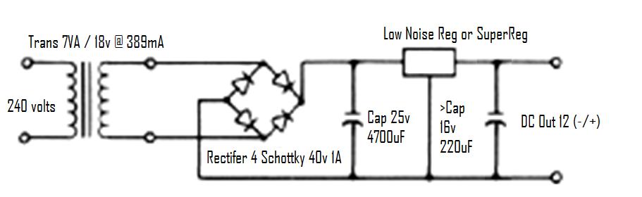

Hi e1roy
The +/- 12V regs are indeed for powering the opamps + hdam. Just replacing these regs with good quality ones will bring good gain (along with better caps). But moving these regs right next to the opamps brings further gains. Any TO220 reg would be fine current wise but the better regs can supply any voltage/current demand quicker than the cheap oem types as well as being lower noise.
The best way to supply a clock is to have a dedicated psu for it, this isolates it from the main circuit much better.
The 7918 is just for the display, changing this for a 7912 would dim the display more then shorting out D852 dims the display further. Doing this almost shuts the display off at the lowest dimmer setting.
Brent

Thanks for the picture Lee and the consise reply Brent, these have made it lots clearer... something else for the Christmas break... going to make a few Ray regs as well.

Yes that psu will work fine. Do not use a cap after the reg if the clock has a cap on its voltage input. The Pana FC 25V 4700uF is a good starting block for this application, if you can go bigger to a Mundorf HC or BHC aerovox then do so (only if you use a quality reg though to reap the benefits).
Brent
