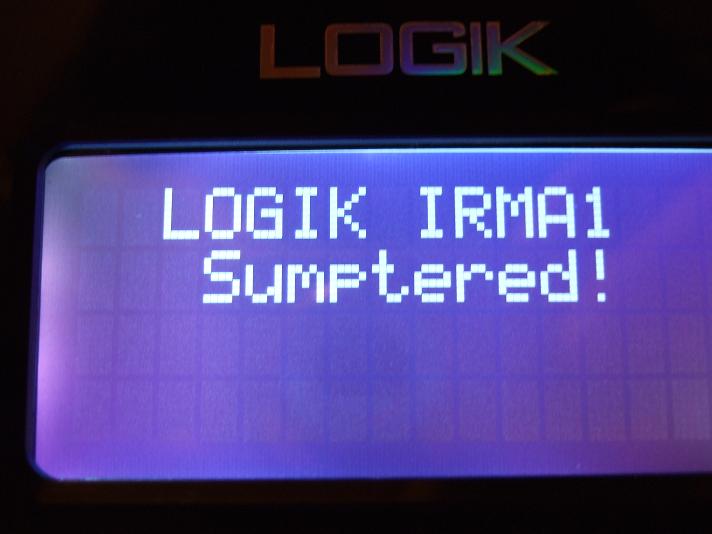

Indeed - very satisfying. It can pick up shares and uPNP from your network - WAVs now sound like a half-decent CDP. It sounds very musical and is still very enjoyable with 128k WMA stations (XFM etc) , which I wasn't expecting.
By the way, whilst I was in the firmware... couldn't resist...
(p.s. my surname is Sumpter...)
Brilliant project Glenn.
rowemeister said:LOL
Do one for Simon that says 'wrecked by Simon' and post pic. 😀
