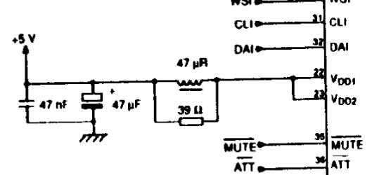

And a more general question that might be a little "off thread." I have a Rotel RCD965BX which uses the SAA7323 bitstream DAC. When I look at the +5V digital supply on the data sheet, I see that pin 22 is VDD1 "+5V supply for the digital section" and pin 23 is VDD2 "+5V for the crystal oscillator."
Both pins are tied together and decoupled with 47uF elco and & .047 ceramic, then a 47uH choke and 39R resister in parallel. (diagram attached)
This arrangement is quite different from the decoupling wisdom on this thread. I am wondering whether I should remove these parts and install a 470uH/2.5R choke with two ferrites beads, then either a 100uF or 220uF Os-con, and then a .1uF X7R cap from the pins to ground. I have these on hand.
Would this be an improvement, do you think? I could also give these pins their own regulator.

The last few posts have been very informative.
However I think the question in my post was lost in the middle of them. It was about DAC supply issues for another bitstream player the Rotel RCD965BX. I was hoping that the gurus here might be able to help, even though it might be a little "off thread."
The RCD965 uses the SAA7323 bitstream DAC. When I look at the +5V digital supply on the data sheet, I see that pin 22 is VDD1 "+5V supply for the digital section" and pin 23 is VDD2 "+5V for the crystal oscillator."
Would this bring an improvement, do you think? I also want to give these pins their own regulator supplied from a separate transformer.
Joe
Joe

jnewbold said:...
Joe
Hi Joe,
I would separate the pins and give them each an OsCon and an inductor to +5V, and see what it does. Pin 23 probably supplies the internal inverters, and some extra decoupling reduces noise in the other power line. If you use a small 470uH...1mH inductor that has some DC resistance (like the 1mH/10R from Epcos), you don't have to use the parallel resistor.
Ray
