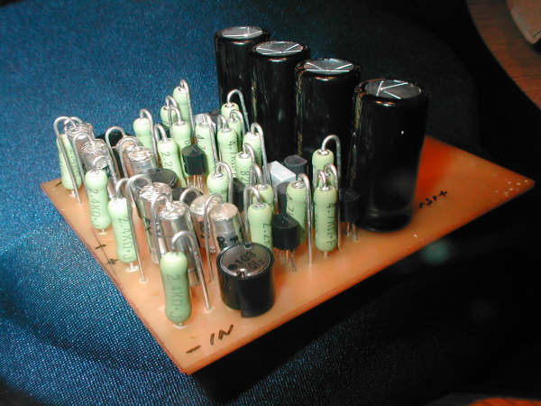

Thank you LeeThomo said:Looking good Ricardo, nice and tidy. That should be a nice smooth performing cd player with that fitted, and should really complement your amp nicely.
Oh, and your parcel should arrive very soon, if it hasn't already.
I must wait for your shippment before I install the DOS.
The caps in the photo are borrowed from another project...
Do you believe there is no problem by leaving the resistors touching each other ?
I am wondering how can I fit the output caps...
My CDP is starting to look very complicated.
Ricardo

RCruz said:Could not help to post this pic of my DOS....
Hi Ricardo,
Sexy picture!! You're going to love the DOS.
Simon
Thomo said:
Mine too! I've found it best to strap the caps to the rear panel.
see the large white caps the black caps tagged on with the long legs are the bypass caps I was playing around with.
Hi Lee
Looks like a mad scientist project...
I see you are using Brent´s lovely psu pcb... are these to power the DOS ?
What smoothing caps are you using ?
Ricardo
