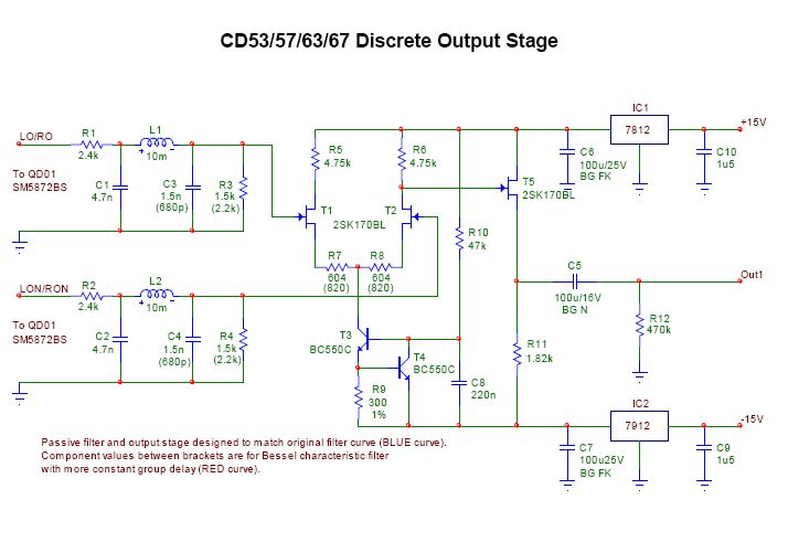

output stage again...
another thing about output stage, this time Ray's discreete.
how about substituting R11 with a pot ?
couldn't one adjust DC offset this way and get rid of the output cap ??
greetings,
Pawel
i am going to fit discreete output, I am just curious, the cost will be rather small for me, I just need some Rs and low-pass filter components :)
greetings,
Pawel

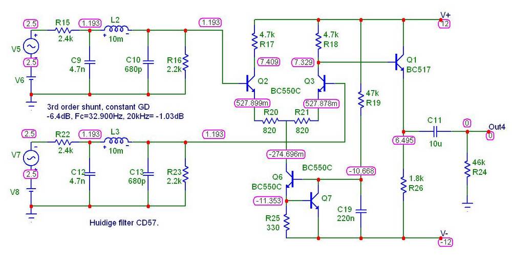

Nope, not possible this way. The only result of a pot is that there will be more or less current running through the output transistor and the pot, but the voltage will not change much.
Take a good look at the circuit. Where does the voltage across R11 come from? T5 acts as an emitter-follower, so any voltage at the base, will appear on the emitter, minus Ube (= ~0.7V). So the voltage originates at R6/T2. To make the output voltage exactly 0V, the voltage at that point has to be about 0.7V, and thus 11.3V has to be dropped by R6, because the supply is +12V. At 4k7, this means a current of approx. 2.4mA has to flow through it, instead of 1mA now.
So maybe the current setting resistor can be made variable. Let's see what happens when you increase the current. The collectors of the differential amp will be at ~0.7V at some point and the voltage at the output should drop to zero. You have to lower R11 to 1k2 to keep 10mA running through the output transistor.
BUT... now there is no voltage left for both transistors to work on! If you want to have an output that swings to both positive and negative sides, you need HEADROOM, or in this case some voltage left ACROSS the transistor so it can swing up and down. The voltage at both bases of the differential transistors is about 1.2V, that's the DC voltage coming from the passive filter. The emitters will be 0.7V lower, so about 0.5V. With 0.7V on the collector, that makes only 1.2V Uce! That's not enough to produce a decent output signal.
Here's a pic of the circuit with the correct voltages included. Oh, how I love my simulation program. :D
This concludes the analog electronics lesson for today! :clown:
