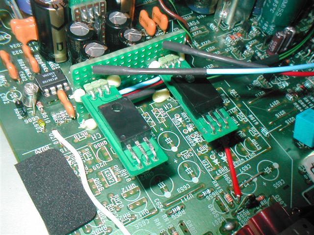

After some trouble fitting the Spower rig near the opamps, I am now rewarded with a much better detail and transient response.
Strings are now believable and female voice is almost perfect.
Ricardo

Very nice! Very tidy too.
Good to see it's sounding good:xeye: (if that makes sense).

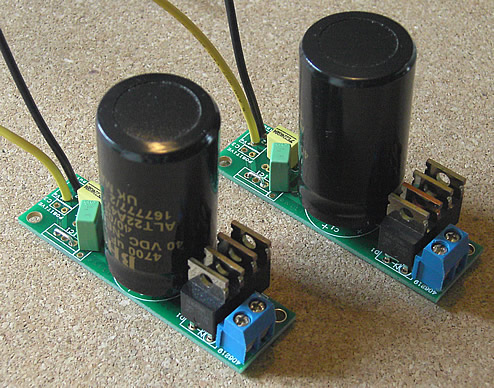

I have had a productive day also. Fitted two extra 5v sregs. So now have them on decoder, hf & servo analog rails. Going to add some dedicated psu's now.
Can't get over how much better than my cd67 this '63 sounds, with far fewer psu's too!
I may post a pic when I've tidied it up a bit and added some psu's.
Lee.

I'm gonna wait til my Mundorfs arrive before building most of the psu's I think.
If anyone has any ideas where I can mount a rather large 30va toroid for my discrete stage, please tell me!
Lee.
Hi Lee.
Mine is inside but you can always hang it on the outside (I love the hanging in the back cool look)...😉
By the way, after beeing connected all night, the noises disappeared and the sound is beautifull.... Now I even hear people speaking in the back stage of Keith Jarret.
I now believe the next mod will be the discrete output... 😀
