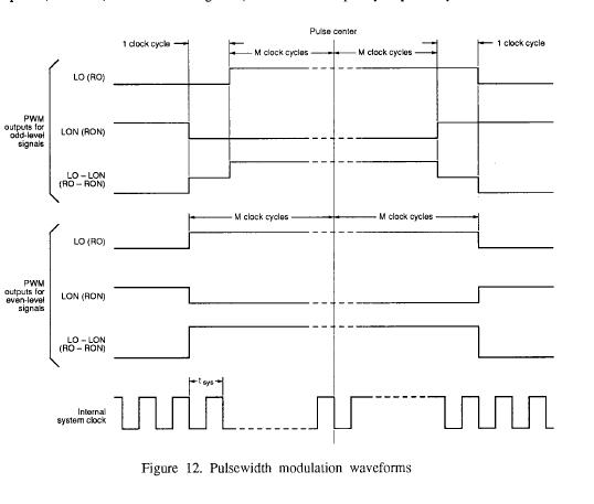

Re: Re: Analogue supply to the DAC
Hi Ray,
So internally there is a resistor divider (dividing 5v to 2.5V), and this feeds an opamp to keep the dac's outputs at 2.5v constant?
These outputs are then low pass filtered to 1.4v ?
Doesn't this mean the 5V analogue dac supply must be very low noise, and impedance ?

Re: Re: Re: Analogue supply to the DAC
Opps.....I've been reading this wrong!
These are digital outputs (buffered, and referenced to the internal system clock).
Could we not reclock the outputs ?
Yes, they are digital 😀
There's a nice 5V square wave on the outputs, but if the duty-cycle is 50% a voltmeter will measure 2.5V.
No analog reference whatsoever...
BUT....the "analog" supply IS as critical as you mention!
Hmmm...reclocking...don't know if that will gain something.
Need another stable clock then. And more stable PSU's.
Ray.
