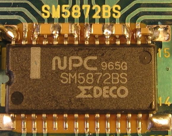

No external clock. I just did the Part 1 and 2 mods from Acoustica.org and upgraded the op-amps in the output section.
I've checked the voltages all around the chip in question and found correct voltage on one the feed side of the various resistors leading in, then found crazy opposite voltage on the other side. Like I said, something is bringing down the voltage on the other side of that chip, I'm assuming its a short through the IC. I'll try removing the chip and testing the rails, but I'm 90% sure this is the problem.

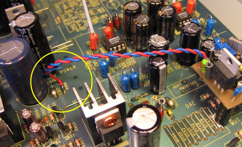

I also have an old L-Clock XO left from my rega cd-player, the frequencies fit; the problem is how to install it, don't have a clue...could need your help here as well...
Do you know what power supply this clock needs? If it's 12V, you can tap power in the player from C813, there's about 11VDC there, should work fine. You can connect the clock's + to U268 (the plus of C813), and the GND to U267 (the minus of C813). See picture. But the best solution is to use a separate power supply with a small PCB transformer and a regulator.
You can connect the clock's output signal to the player by removing CD02, CD03, XD01, RD02 and U209. Connect the output of the clock to the hole of U209 that's next to CD05.
