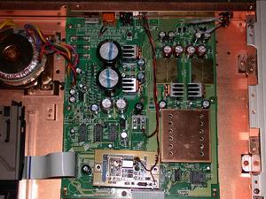

I have just downloaded the CD17 MKIII service manual to compare circuit's with our machines.
It as two mono DACs (shielded) straight to the HDAM. No OP AMPs used at all.
The HDAM is pretty much the same as ours and the muting is the same with a few resistors having lower values.

When I first changed my caps around regs and dac to blackgate the first thing I noticed was a better more natural sounding bass with a slightly better/smoother mid range.
And I know running the machine more and more can only improve things 😀 and then my laser will fail
Having looked at the diagram for this player I know my player is much better, the psu are better than standard 63/67 but not amazing.
The circuit layout is much more linear (better routing of tracks) and there for better.
Also the +/- 12v regs for HDAM are situated right next to the HDAM.
Just like my +/- 12v regs for op amps 😀
Pic of KI model shown

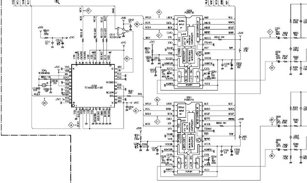

rowemeister said:Here is a the sch of the DACs in the CD17 mkIII.
These output audio straight to the HDAM
DAC PCM1716
they are using pcm****'s
very hard to read
have you got the schematic of how the used the HDAM's
looking at using passive filter to fet buffer.
have you seen the D1 output?
allan
