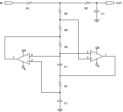

Hi.
What about replacing the LC filter between the 2 op amps with an active filter?/
Andy

awpagan said:
or fet balanced stage
allan
A balanced stage , whether TUBE or fet, will only cancel "common mode noise" but noise is, by its very nature, random.
The LC notch filter is tuned ( I forget whether F or nxF ) and complements the filtering performed in the DAC and by the RC filter post-DAC.
This is the type of filter ( active ) found in BurrBrown data sheets. ( not that is necessarily 'good'.)
http://www.hagtech.com/notch.html
This gives nice results with 44k notch and 1000pF (Si-Mi) caps
Andy

Hi Andy,
You got me wondering why the notch filter is no longer present in the CD57/67 (the 1000pF and 220uH in the CD63). Maybe just a simple cost-reduction that no-one will hear.
It is supposed to be tuned to 8*Fs. I entered the whole Marantz filter in Micro Cap, and i'm going to do some more simulations to see if I can optimise it further. I want to improve the group-delay as mentioned on Pedja's site, and re-tune the notch filter closer to 8*Fs and see how that sounds.
Ray.
........ re-tune the notch filter closer to 8*Fs and see how that sounds.
Hi.
Not having diagrams for the 57/67 , I did not know that !
Are the post-dac components the same??
EDIT. Oh, yes. I have !!!!!
With only the 1000p cap and no inductor, it would roll off at 6db/octave (??) rather than notch? what would be the knee freq.? I can't compute - no software.
What effect would there be in adding an extra RC ( 10k/120pF ) stage in front of the first op amp?
Similarly, adding an extra 10K and 1000pF ( and for 57/67 an extra 220uH ) between the op-amps??
Andy
