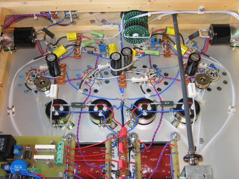

Ok, can't stay behind now
Amp: DIY Ultralinear KT88 class-A push-pull tubeamp, solid silver & teflon signal wiring, Elma & Holco stepped attenuator, Auricap coupling caps, Kiwame anode resistors, BlackGate kathode caps.
Speakers: DIY Vifa Vivace '94, silvered & teflon internal wiring, MKP & KP-SN caps, modified tweeter, bitumen and Pritex damping.
/offtopic

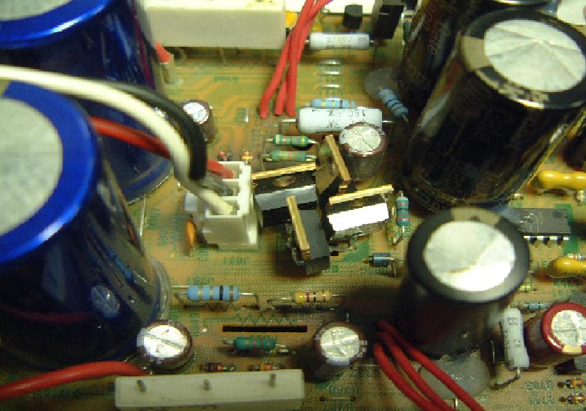

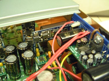

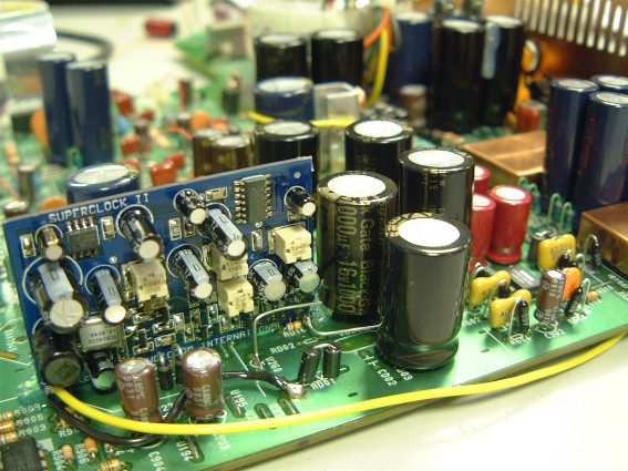

Your clock is tiny! Mine was the first Kwak clock I made, and I used some very nice, but big polyester (I think) 1uF caps in it. There about an inch high, as well as some electrolytics.
Currently, its just mounted above the decoder using a pillar screwed to that hole in the corner.
All was fine until some of the caps grew up🙂
For a while, I also had a small board with three 7805s and associate caps floating just outside the case by a collection of wires. Worked brilliantly, but needed mounting quick.
Will probably fit another board with regulators on somewhere as well.
Nothing is finished yet, so there is scope to do all this.

Yep, that's the sort of thing I've done. Hopefully, will be doing a bit more of that with time 🙂
I also have decent phonos hardwired to the opamp outputs, but they have to be attached to the rear panel which is inelegant as they're soldered and chassis mounted. Fine if you don't want to dismantle things.
This is probably why I will delay the coax mod 'til later. more delicate parts.
At least its all screw terminals so it can be removed easily if needs bed (except the phonos, terminals would defeat the object).
Maybe the whole player needs re-enclosing? 😀
Perhaps that way, there could be rather major mechanical improvements 😉

Hello Ray,
thanks for clarification about the ceramics; actually i'm not planing to swap out all ceramics, but related to the diodes i did this once in my rega and it "helped";
Do you think the BG's will give me trouble in that position?
Some more questions to come, i'm afraid....
I swapped out DN03 + DN04 with Schottky by mistake, not realizing that they are not mentioned in the mod-list...can i leave them in?
I also changed the op-amps into OPA 2134 (i had them) - and the sound got worse (lifeless, grainy, harsh)!
I didn't expect that the 2134 are worse than the JRC...any of you had similar experiences?

mickie said:Hello Ray,
Nah, no problem. That position is not critical. You should be careful around the digital chips though. Use a good electrolytic with an X7R ceramic or PPS (even better) in parallel, as close to the supply pins as possible.
No problem. They are rectifiers, so it won't hurt to have schottky's there 😀
