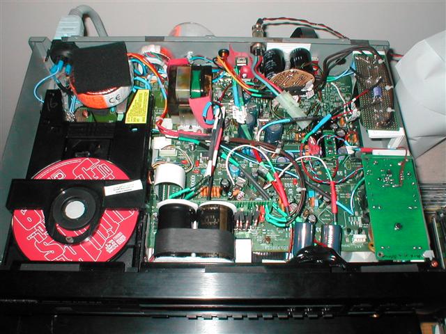

I finally managed to mount my output caps to the cd chassis:smash:
Sorry for the poor quality
And please ignore all the wires, they will be tidied up when I get round to installing the additional psu's.
Looking good now....
My clock setup looks like a power plant..😀

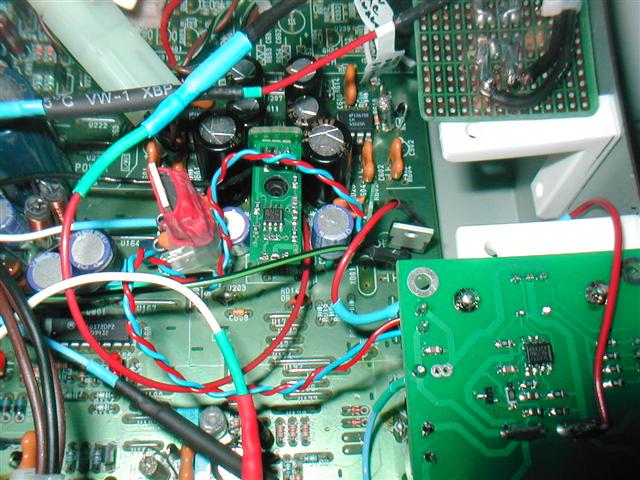

I'm now ready to get going with your discrete output stage as my 8260 is the same as your 8400.
I have a question about the power connection. Your design shows +-15v followed by a 12v regulator. Where are you getting 15v? Power on the board is 12v already. Why the extra caps and regulator?
Steve
Hi Steve,
I used on-board shunt regulators on the discrete output PCB because the regs are closest to the circuit that way. It's a single-ended design, so it's quite sensitive to PSU noise. I used the players' analog supply as pre-regulators to power the PCB. The output voltage was modified to around +/- 16V by changing R853 and 855 to 4k7.
I'm curious what you think of it, can you let me know how it sounds?
Ray
