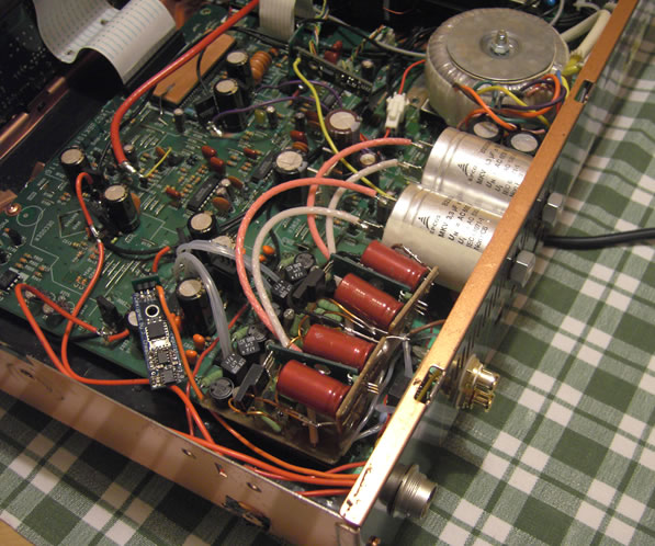

I'm having a crack at upgrading my output coupling caps tonight. So far I've had to remove the remote control sockets and the digital outputs, and remount the discrete board in order to create enough space to squeeze the big Epcos MKV caps in.
I seem to have disrupted something critical in all that moving and pcb bending... this is proving to be quite a task!

SimonSimontY said:Indeed!
You are brave!!!
You have my sympathy
The results will be equally rewarding, of course.
Ricardo
I probed some voltages and it started playing again, so no real problems there 😱
I drilled the rear panel to mount the new caps, repaired the connections from the muting circuit and discrete board that broke off. Then I wired in the new caps and put things back as they should be...
It still plays but there's no sound yet. The new caps barely fit, looks quite cool. Pics to follow soon.
Simon
SimontY said:Oops, I see a power rail that's come loose, and a signal wire 😎
I guess it had to be something 'simple'.

I've lifted two tracks from my discrete pcb. I previously weakened it by drilling the pads out to accommodate very large cap leads (old 22uF WIMA films), and the repair-work was hard to do with all the short, thin silver leads attaching the DAC at one end and muting cct at the other!
Repaired these and it sounds awesome, from one channel lol. There must be another dead signal connection, which will have to wait till tomorrow.
I did another small tweek whilst I was in there:
Hi Simon,
As a junior padlifter (oooh missus! ), I've stopped drilling out holes in PCBs to allow larger leads than allowed for. I tend to put a pcb pin in place instead. Since I started doing this I've not had any more problems.

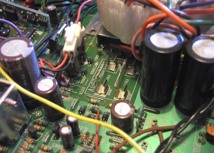

This weekend I will place the C1 on the servo.
As yesterday I broke the connections for the 10.000uF placed after the +-12v sregs, I will replace these by 470uF BG. (Size matters)
Hope this modd does not compromise the sound in any way.

Thank you Brentrowemeister said:I'm sure it will all be fine 😉 I have full confidence in you.![]()

Another question:
What should yield better results:
Replace C805 / C806 by 470uF BG or something bigger like 4700uF Pana FC ?
Or should I remove these and place the 470uF nearer the opamps U208 / U209 ??
As you know I had linked in C805/806 a pair of 10.000uF but the wire connections broke last night.
Actually the sound was quite good with the 10.000uF but the wiring is horrible.
Please advise.
Ricardo

That's a good idea Pete! I wouldn't do the drilling on something like the discrete board again, it just doesn't allow for easy component swapping.
Well of course the player it working sweetly again (I'll say no more about that) and I've just really hooked it up and am letting it warm up now.
The first impression with these Epcos MKVs is that they're very bass-light. Perhaps as a side-effect of the lacking bass weight is a clean, detailed presentation.
The difference in bass is so obvious (and it's very obvious when you connect another cap, say Mundorf MKP, in parallel - loads more bass) that I almost wonder if there's a roll-off problem. Or it could just be burn-in time. These caps worked wonders in my preamp, and weren't much different to DC coupling / no cap. This is odd
