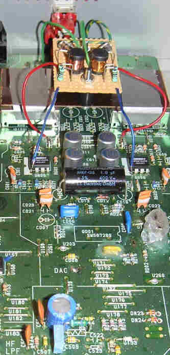

I managed to get two decoupling caps under the IC sockets. I use this setup only for testing. After I find a good SMD opamp combo I solder them on a single-to-dual SO8 adapter that goes into the player.
Ray.

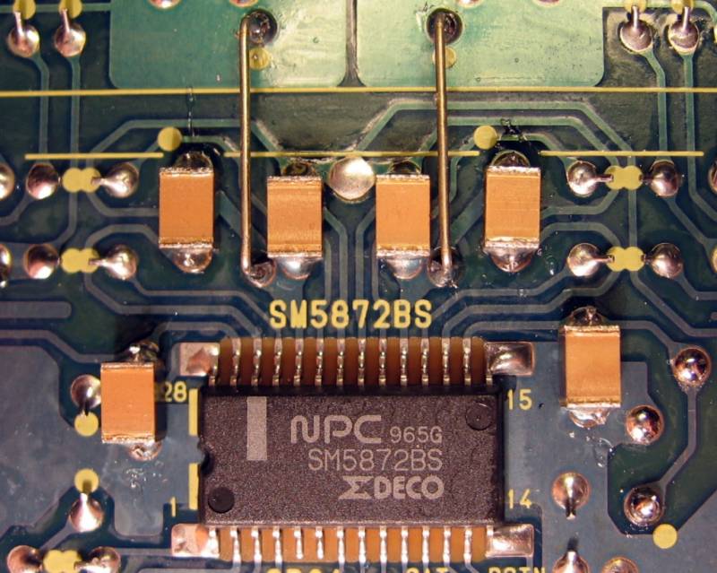

davidsrsb said:Both the CD63 and CD6000 families are let down by the single tracking layer plus ground plane aproach. Most of the chips and decoupling have very indirect 0V connections. A few well placed chip ceramics might have far more effect than all of these audiophile exotica being suggested.
Looking at the supplies around the smd chips, even their 0V connections are noisy and the +5V is worse. The master clock is obviously jittery and the 470R series termination resistors in the clock outputs to the DACs and servo is too large, turning the secondary clocks into 3V pk-pk triangle waves. A suitable ferrite bead could give a much cleaner clock.
I agree, the PCB is not optimum. The CD57/67 layout is better though. But the local decoupling is also very important, a few small caps make a big difference!
I use a lot of 100n PPS capacitors on the bottom of the PCB, to replace the original 47n ceramics, and to put in parallel with the swapped el-caps.
Ray.

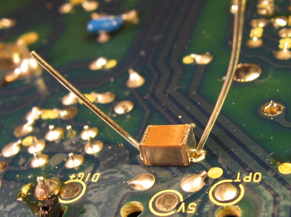

SimontY said:I wish I could solder like that!![]()
It's not too difficult. Use an iron with a fine tip that's not too hot, and thin solder wire with low-flux core. Place the el-cap in the PCB and bend the wires. Place the PPS cap on the bottom and solder it, that's all!
Ray.
Ahha, I see the 'trick' to it now, very sharp pic, thanks. I've never even attempted to solder SMD, but as I get better I may try some caps. My DIL op-amp sockets are just looked after by 47uF Pany FC under the pcb.

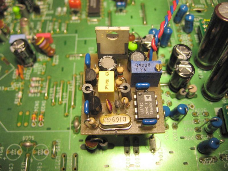

As an alternative the Kwak-clock is very easy to build. You can also use the single-supply version. Or you can use a Tent labs XO oscillator module, also works very well, with even less parts count. In the picture you see a small PCB I made, with a Kwak-clock oscillator and buffer, and a two-stage PSU. But you can also use vero-board.
As for the opamps, if you go for dual ones I can recommend the AD8620, you will need one for each channel. That will give you a lot of improvement compared to the original JRC2114.
To cure the skipping problem you can try cleaning the pickup lens, with a bit of isopropanol and a cotton-tip. If the lens is clean or it doesn't help, you can try and increase the laser-current a bit. There's a small adjustable trimmer on the flexfoil of the laser-unit. If you carefully turn it a few degrees clockwise that may help.

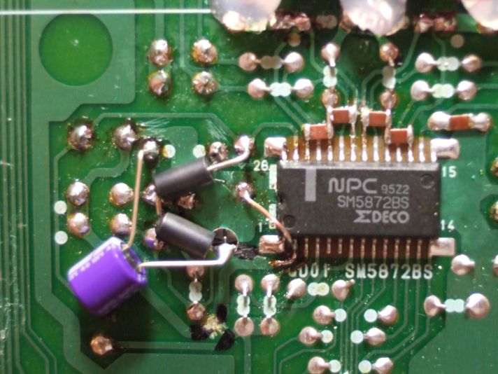

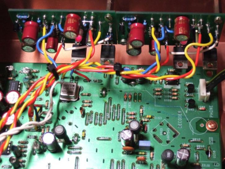

More caps exposed..
Next to the dac is a tent clock, right on the pcb. PS comes from an alw reg which also feeds the +5 clock ps on the dac.
Second alw reg for the +5 analog ps on the dac. Both have are fed by a 317 ps with own transformer.
Rest of the mods is like mentioned here (opamps/mute/headphone/etc).
it's a 63ki
it's a 63ki

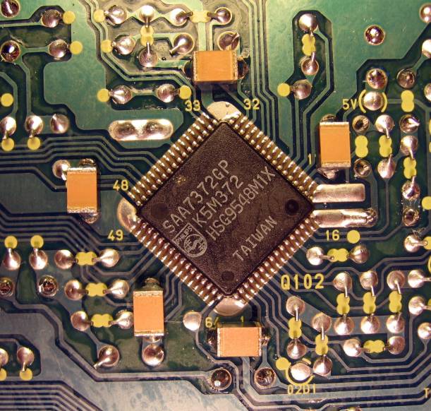

SimontY said:Ahha, I see the 'trick' to it now, very sharp pic, thanks. I've never even attempted to solder SMD, but as I get better I may try some caps. My DIL op-amp sockets are just looked after by 47uF Pany FC under the pcb.
Here's the decoder part. I also use SMD resistors in the analog filter. They are small 0,1% MELF type. They fit exactly between two pads and are far less expensive.
Ray.
guido said:More caps exposed..
it's a 63ki
Hey, nice job Guido! Should do that too actually. More caps closer to the chip. What case size did you use? If it gets any smaller we'll need microscopes!
Ray.

www.dutchdiyaudio.nl 12 maart.
DJNUBZ said:I just want to make sure we are talking about the same thing. Rather then building or buying a whole clock unit I can buy the € 29 oscilator and just plug it in place of the crystal?
Yes that is basically it (you have to remove the caps and resistor too). HOWEVER it only improves things if you also use a very good powersupply to feed it. In my case an ALW reg with preregulation. Or indeed buy/build a clock with powersupply included, many flavours to choose from.
Browsing through the digital section (search) should give you plenty to read.
Opamps are DIP package ( and they are dual opamps) replacement is rather simple, but if you put in a fast opamp (like that 6172), the decoupling needs to be improved. Otherwise it might behave badly
My CD63 is now strictly modded by the Gerald Gessner style. This includes improving the power supplies for the DAC chip, changing ground layout and completely redesign of the output stage (just one OPA(2)134, passive filtering, no output caps).
One very interesting detail, I was not aware before: I inserted a Kwak Clock with the original quartz.
But the original Quartz is not precisely enough! It is a 16.935Mhz and not 16.9344! I does absolutely make no sense, to insert the original quartz into a Kwak, for this player!
