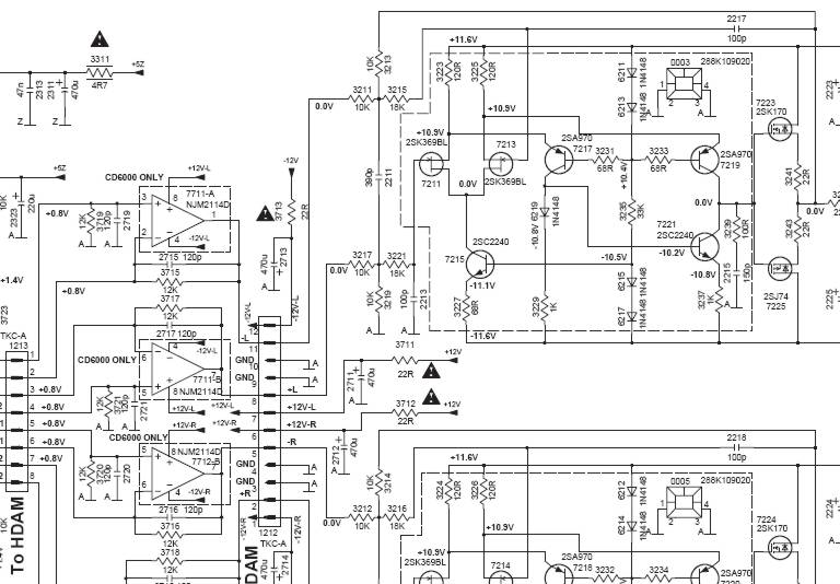

kptseng said:
Hi All,
I've heard of some mod that bypass or replace the HDAM circuit with Op-amp.
I'm using CD6000 and hope I can get some insight to this mod.
Thanks.
King
Hi King,
The CD6000 is a different story. It uses two SM5872 DACs (lucky you...). The 'normal' CD6000 then uses one 2114 dual opamp per channel in the filter and a HDAM circuit as buffer, the OSE uses dual HDAM in the filter, on a separate PCB, and a HDAM as buffer.
I think it would make more sense to try and replace these two 2114 opamps with decent ones.
The HDAM buffer part uses differential inputs because of the dual DACs. It's difficult to bypass this because it also does some kind of differential-to-single-ended conversion.
Ray.

Luke said:
Hi Ray,
so what your saying is that if you use a crap opamp, the hdam will improve the sound. If you use a good opamp the hdam will improve the sound?
Seems to me KI would be well aware of this wouldnt he? Surely a decent opamp is not as expensive as the sexy copper cans alone🙂
But you got me curious and I would like to try this although its not minor and I blew my last player up🙁
cheers Arthur
Hi Arthur,
Well, allmost. With a crappy opamp the extra HDAM circuit MAY improve the sound. With a good opamp already in place, chances are great that the extra circuitry will degrade the sound.
As I said, the shiny cans and the HDAM circuit are a great selling point, you don't get it in a CD57. Also they don't want the player to sound TOO good for it's money. The CD57/67/67OSE/67KI all use the same PCB, DAC, decoder and so on. They just change a few parts in production to make different sounding players. But this 2114 opamp is even used in more expensive players, like the CD17!
Ray.

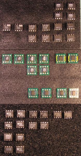

www.farnell.com is a little cheaper, especially if you are satisfied with the A grade. But why do you want to use four of them? You can use a cheaper one in the filter, it's less critical. And it will make your player sound less ''Brown'', if you know what I mean.
If you look in my opamp list you'll see OPA124 has good spec's also.
You can also sign up with Analog's sample program and get some AD8610, for free 😉
Ray.

It is good, but there are even better and cheaper alternatives, even for free if you use the sample programs. I didn't pay for all of these 😀
The OPA124 or AD8610 can be used instead of OPA627 after the DAC, and then goes on top of the adapter, that's IC1. In the filter I use OPA132, AD8510 or also AD8610, this goes on the bottom.
If you look in the opamp table you can pick one that has nice specs. For the DAC low input offset voltage and low input bias current seems to work well. The more yellow the better.
Ray.

LOL nice stock. It looks a like my stock of eproms I program for car ecu's.
I have purchased 2X OPA627AU and 2X OPA124UA from Farnell.
They came to £42 ish. I thought this was ok.
So with these chips I put OPA124 ontop (ic1) and the OPA627 on the bottom (ic2)
I have just ordered some gold plated sockets for the pcb to fit into also 😀
No, i'm afraid you didn't read everything and ordered too fast. :whazzat:
The OPA124 or AD8610 can be used INSTEAD of OPA627 after the DAC, and then goes on top of the adapter, that's IC1. In the filter I use OPA132, AD8510 or also AD8610, this goes on the bottom, so that would be IC2 on the adapter.
