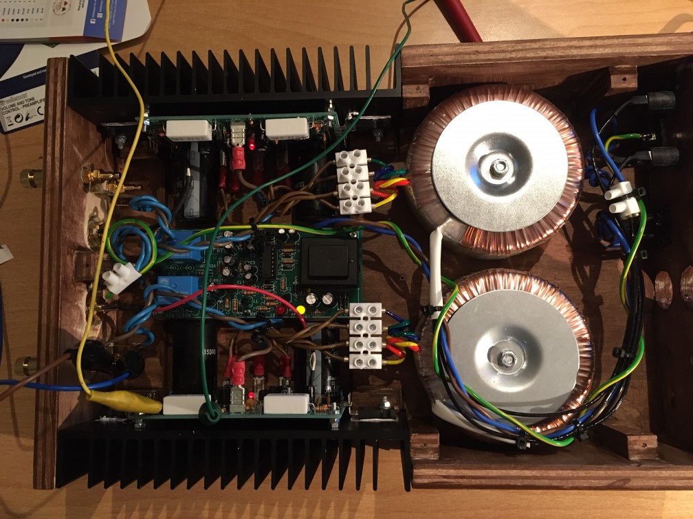

The super regs you see on my picture were only £16 each off ebay and they were the perfect size to fit between the big caps.

On a different note, has anyone tried removing the transformer and housing it in a separate box, for purposes of isolation?
My clock psu is external, so I thought I could combine them in one box and have no transformers in the player, just a DIN connector or molex style or similar.

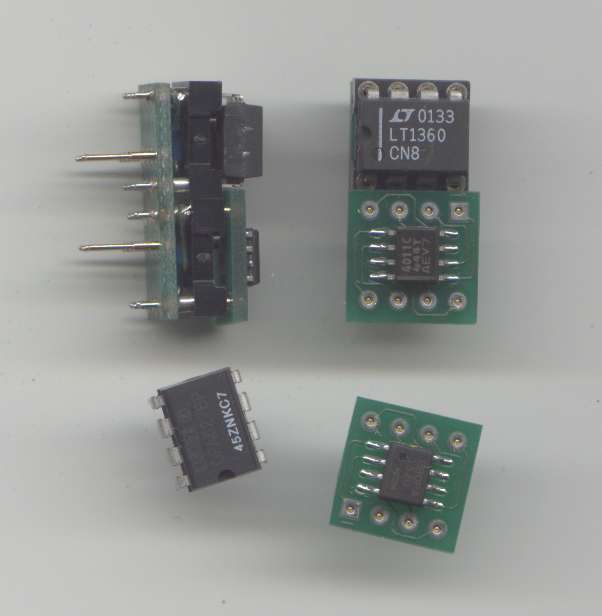

I use mainly single opamps, with the SMD's mounted on some extra DIL adapters. I compared a lot of combinations with a single to dual DIL adapter. There lot's of good opamps only available in SO-8 these days.
Ray.

Re: adapters
Interesting. The pic, which is good, makes me wonder about all the extra trace and pin path for the signal. Does this not make it of paramount importance to place psu caps on each op-amp?
cheers
cheers
