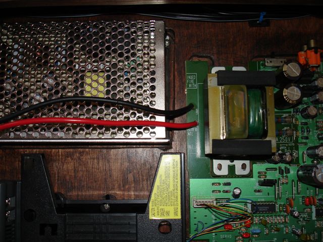

Hi
Yes it is an smps in my cd63. In fact there are two, one 12v, and one 24v. See photo below. Having smps inside my "music centre" may not be ideal, but I wanted a standalone unit with one power switch.
I have cure the mains tripping, there was some leakage due to a poor connection.

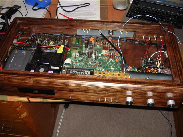

Upon reassembly of the unit, the digital problem has come back. It seems that the rca socket has a short inside. The CD goes backwards! I will try and bypass the socket.
I will start a thread when I have finished.
This is good looking indeed.
