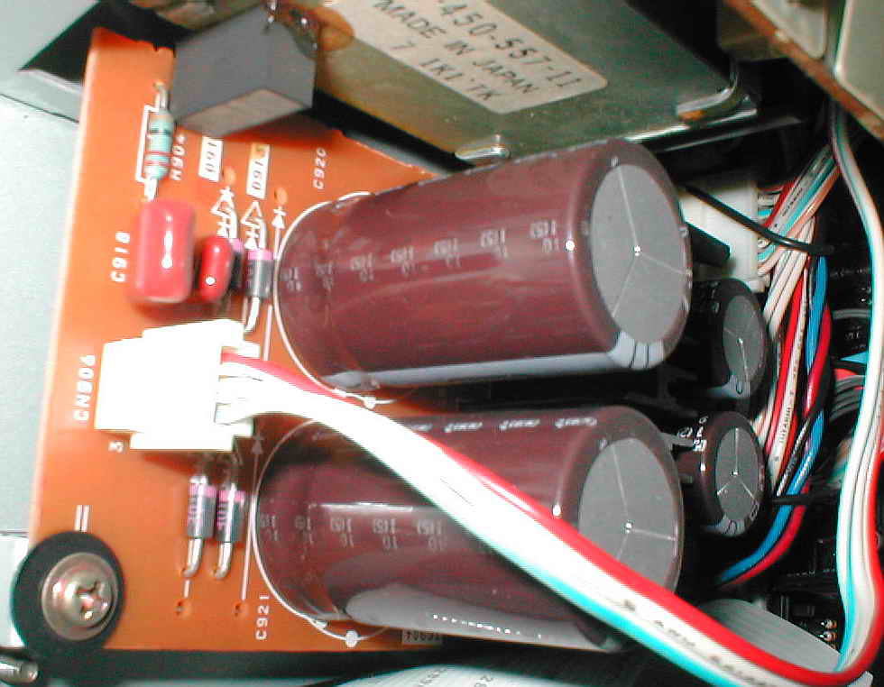

RCruz said:Hi
I am now looking at the external DAC PSU..... Can anyone tell me what is the little black part that seems to be glued to the TX..?
Can anyone help me identify the little rectangular section part glued to the TX ?.... Please see pic above.
Help
Ricard0
Help![]()
Ricard0
Ricardo, it seems to be a piece of plastic used for mounting purposes.
André
