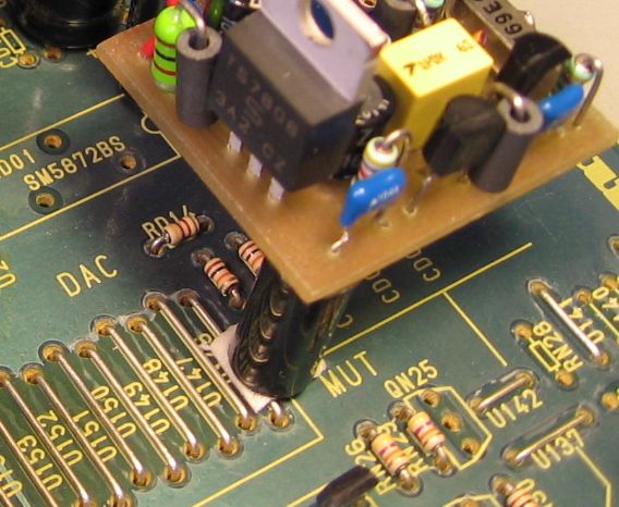

Another one ready to rock.

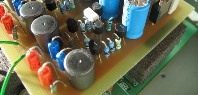

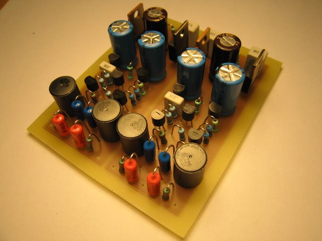

Are those Toko 10RB shielded inductors?
I just got hold of some of these (the 5% 'J' ones) and it took me bloody ages to find them!
The ones I used before picked up hum and I'm hoping these will cure it.
They might be, compared to Toko' web, they do look similar. They are indeed shielded.
I don't get any pickup what so ever - not anything else than sweet music.
Perhaps I doubted you who said, that there was more beyond a hotrod opamp. There is. A discreet filter and buffer. I am hearing things now (from the record) that I couldn't hear before. There is just more of everything now. More music!
Thx. Ray and anyone else who has been involved in this output stage. Great work.
😀, big 😀

ground plane
hi this may seem like a stupid question but im quite a noobie at this, if i make a circuit board for the output stage how would i fit it in the player, could i screw it down or will this mess up the grounding, if you know what i mean?
thanks
chris
thanks
chris
Re: ground plane
Hi Chris,
You could screw it down, but most of the times there's no room for drilling fixing holes in the player's PCB without damaging the copper traces. Or you could short-circuit things with a metal bolt or nut. I usually glue a few distance studs to the underside of the PCB-to-be-added and then fix it to the main PCB with glue or small pieces of double-sided foam tape. Or I use tape on top of the HDAM cans or the electrolytics combined with some studs.
Ray
reddish75 said:hi this may seem like a stupid question but im quite a noobie at this, if i make a circuit board for the output stage how would i fit it in the player, could i screw it down or will this mess up the grounding, if you know what i mean?
thanks
chris
Hi Chris,
