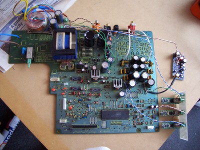

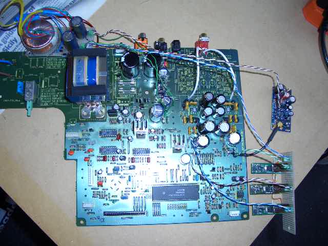

rowemeister said:Its interesting that your findings were half the VA of mine Ray. Of course I had HDAM connected and you did not.
Brent
Yeah, I think the HDAM makes a big difference. That's quite a current-drain. I use a nice small toroidal that I found at Farnell for the analog voltage.
Ray
I have a small Nuvotem toroid 2 x 12v for the digital & analogue, plus one 15v for the clock, plus the CD67 Special Edition for the opamps and other bits. The gains have been tremendous so far, so I'll look into another for the opamps.
Any idea what Multicomp tx's are like?
Lee.
Lee.
Ray
Excellent stuff. I am not suprised how much diff its made over the standard 63 tx really. It should also be better than the KI winding too. Hope I can squeeze the 30VA in LOL
here is a pic of the Nuvotem from RS
Nuvotem
Brent
Thomo said:I have a small Nuvotem toroid 2 x 12v for the digital & analogue, plus one 15v for the clock, plus the CD67 Special Edition for the opamps and other bits. The gains have been tremendous so far, so I'll look into another for the opamps.
Lee.
I have not used those so I can't really comment.
Brent

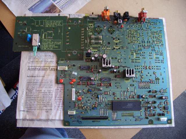

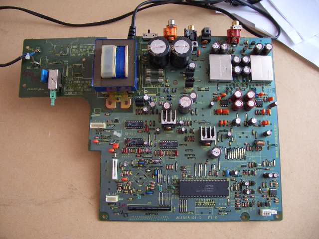

Marantz CD63KI transport
Hi Brent,
I see you have the original ribbon connectors J102/ J103. Just thought everyone should know J102 in my cdp was bad due to cold soldered at several pins in the transport. After numerous times when errors were displayed, finally decided to replace J102/103 I was shocked to find J102 pins could be pulled out easily from the pcb without a soldering iron!!! Maybe it is one of the problems faced by our fellow diyers having similar transports by causes unidentified. Maybe it only affects pre-1997 year of manufacture.

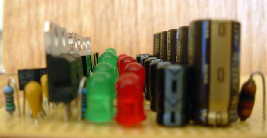

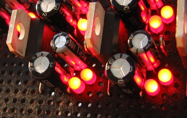

As said I'm busy fixing my rice cooker, but I wanna ask you how to make a Raygulators, in fact 2, but not 12V as the originals ones but 5V for the DAC.
I guess it's only change in values but I don't know how to calculate it. I'll feed both with a separate TX, maybe buy another one to feed the opamps Raygs.
Thanks!
Thanks!
Malefoda said:Hi there!
Thanks!
Hi. I used a 120r resistor and one green + one red led for the voltage drop.
Lee.
Lee.
I did it with two reds. I don't know why, but my greens gave me aprox. 2V each, and with 1.25 on top, I overshot the 5V. With two reds I ended up with 4.9V.
Malefoda said:I need more dude, like Ray has done with his Rayg's pics & list.
Here you got more.
Or just use an 360 ohm resistor as buddy to the 120 ohm.
