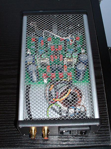

I noticed you kept the op amp output along side the Discrete Out. Beware of noise (of the common mode type) entering the analogue signal between the DAC and the input of your board. Keep a short distance if possible or use twisted pair or shielded cable (Prefer AV-14) for connection. A Cage of Faraday over the board would be nice too.
PS ImageShack has excellent bandwith for hosting graphics.
Chivvyp said:bit better picture
Keep them regs close to the consumer so they work optimal. Keeping your head phone amps is slightly degrading your signal because of the long traces originating from the RCA's. You might consider a switch at the back to decouple the 'radio antenna' to the phones section.

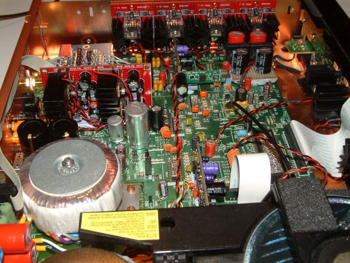

6h5c said:...I use a nice small toroidal for the analog voltage.
Ray
rowemeister said:I am not suprised how much diff its made over the standard 63 tx really. It should also be better than the KI winding too.
Brent
Guys,
Toroids are cute but their only advantage to a split core is the absense of a strong magnetic field. In terms of isolating HF garbage from the mains they are even a less obvious choice...
disco said:Hi Si,
Hi Jaap, great to see you posting on here again.
Does this advice apply even with the op-amps not connected to power or signal? They are not currently connected to either.
disco said:Guys,

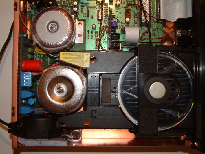

I've wondered about what the optimal choice is for when using external supplies. I currently use two toroids and one "split core". The latter powers my clocks. I chose it for that location to minimise noise transfer back to the primary (based on something I read).
It must be said that toroids are also very small and I don't think one could fit many into a CD63.
Simon

Thanks mate. You lost your innocence since the last time, as I noticed a new picture? :]SimontY said:Hi Jaap, great to see you posting on here again.
I was referring to the distance your connection is travelling from DAC to the output board. Keep it short because of high frequency noise arriving at both wires (containing the symmetrical signal).Does this advice apply even with the op-amps not connected to power or signal? They are not currently connected to either.

Small == cute, alright. But what are your design goals? Can you live with less than slick looks under the hood? There's a masculine quality in big heavy iron on top of your player. Put more weight in it, that's the trick
Seriously, one shouldn't be too anxious about the clock signal 'polluting' the PSU. If you must insert a 10mH common mode filter coil followed by a 220uF cap in the supply. Corner frequency, anyone? The load by the clock is not that big, I guess less than 1mA.
It's a good habit to make measurements like Ray does and Brent is getting used to 🙂
Hi Jaap. Thanks for the comments. I have no more room for any extra boxes so it all has to be contained in the player. Besides the dog likes to stick his nose into anything left open, not good for him.
Don't suppose you have any of the boards for the discrete output stage available do you?

Hi Lee,
The work involved in making -let's say- ten prints is quite demanding (for me that is), mostly because of the drilling with 0,8mm. If we want a small quantity manufactured they would probably cost no more than £ 8 each. Problem is what to do with the remaining samples 🙁
There's life besides the toroid. These trannies are great fun when soldered on a PCB, the smallest is 6VA and does a double 0-12V. Size: 3x4x5cm.

I must admit, that I have used two non-toroidal's in my player and haven't found any problems so far. I did use a Block tx, and it got so hot that you couldn't touch the thing. It melted the adhesive on the mounting brackets and fell-off. This created a large crack, some sparks, a blown fuse and a bad smell😀

seroxatmad said:would you say the KI version wasted the money on a round transformer? Did it actually add anything to the sound quality? i.e less vibration? Better regulation? Less noise out of its secondaries?
I'm glad I've whetted your appetite for CD63 modding, John!
IIRC, Brent directly compared the KI's toroid to one of the other models' transformers. He was surprised at the large gains in sound quality.
I think if all other factors were equal (materials, capacities/headroom etc.) the toroid might not have been superior. However, it was chosen as a quality part, and the cheaper E/I core ones as a cost-saving part.
Don't get hung up about it though, you can add your own transformers - like you were saying. A few of us have done this and I can tell you the gains are astonishing. The bass weight you lose from cutting out the HDAM comes back in force... but this time it's tight and tuneful! 😉
