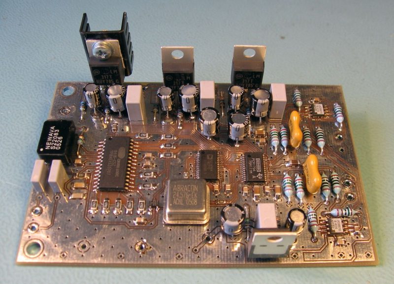

I'm hoping to tell you soon... Both my 67's have an extra small toroidal now, that feeds the analog stage. One of them still uses the good old opamps in the filter and the other one has the output PCB installed. Both of them have nearly identical mods, and both have a Flea installed. This way I can do a nice A-B comparison between the opamps and the outputstage 🙂. I also have a 63KI that is almost finished and modded in the same manner. Then I can do a A-B-C comparison 🙂. But I need a Flea PCB for it, anyone happen to have a spare one?
SACD is a whole different ballgame, my SA8400 leaves both 67 players in the dust, and I don't even have to play a SACD 🙂. But maybe there's still hope for the 67's, as i'm working on a DAC right now (one of the reasons I haven't been posting much here...) that already outperforms the CD section of my SA8400 while it's not even finished yet! It's the EzDAC, that uses asynchronous upsampling to 24/96 and a PCM1794 DAC. Very nice first listening results! Not finished yet, I want to fit a Flea in there too, for the 24.576MHz clock, anyone happen to have a second spare PCB 😀? I wonder if it's going to beat my 8400's SACD playback, it's already somewhere in between now...
So maybe the 67's are going to beat the 8400 as a luxury transport...
By the way, the upsampler of the EzDAC accepts I2S input data, so maybe it's a nice plan to leave the CS8416 S/P-DIF receiver out and hook it up to the decoder of the 67 directly?? The PCB is small enough to be fitted inside a 63/67. Instead of only an outputstage you just replace the whole DAC-section. If you guys want to take your CD playback to the next level, this is definately worth investigating.

<OT>This new DAC has gotten me very excited. It's not an easy task to build, with two 28 pin SSOP ic's and all the other SMD components on it, but it's not very expensive if you consider the results, it sounds very good. It will wipe the floor with some major $$$ commercial DAC's. Can't wait to have another listening session with some of those 'audiophiles' with fat wallets and their $$$ off-the-shelve stuff 😀.
There are some nice pics of my DAC-in-progress (and others) in this thread, if anyone's interested.</OT>
