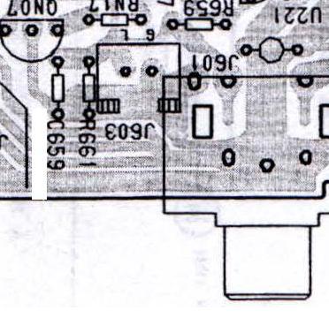

Hi Andy,
I scanned the PCB-layout of the CD57/67 PCB. If you want it I can send you a new CD57_67_doc.pdf, just give me a PM.
Ray.
separate analogue from digital
allan

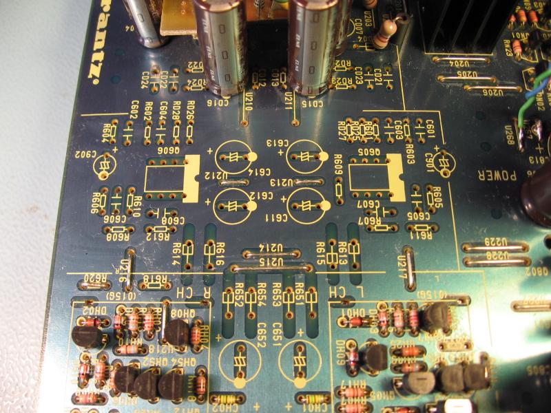

allan
Hm, I wish it were that simple....
You would want to keep the top trace, cause that runs to the +/-12V groundpoint 😀.
All the local groundpoints are also connected through the top-layer groundplane. Not bad, but they should have designed a real double-sided PCB. That would have saved a lot of wire bridges. Maybe in the future i'm going to solder some litz wire across the board.
A virgin plain PCB, ready to be mounted 😀
(with Thorsten's circuit, that is)
Hmmmm top ground plain, dam forgot about that😱
o'well
looks like i'am going to have to take the pcb out again
this time just looking at ground planes. 😀
new pcb?
how about i2s out to separate dac etc
but this destroy's all the fun😀
allan
